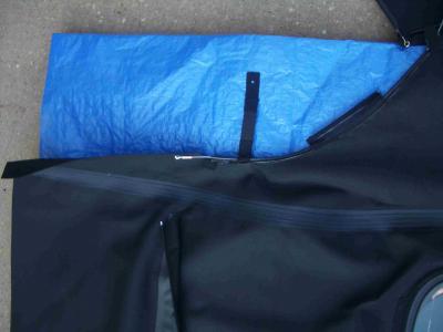

  4. Maurice, thank you very much for your information and your kind words. With that recommendation in mind, I will definitely exchange the red ball cups! Concerning the foam sealer: There I got me some foam which is adhesive on on side. Out of this foam I cutted two pieces that should be very similar than the old ones. As adviced, I spared enough material around were the philips screws will be later. Now lets come to the slider! Thank you for the link. In fact I read the thread during my preparation and had the clear feeling from this, that the old slider ...7000 out of my car will be way shorter than the updated slider I buy (...7002). It was a big surprise for me, that the section of the slider where you slide the canvas in is about 1 inch longer at my old slider. I compared part#: The old slider has the ...7000 on it, the new slider has the ..7002 (but is shorter ?!?!?). On the slider-picture, the left parts is what I bought new, the right parts (longer) are what came out of the vehicle. My feeling tells me, use the longer slider. My brain tells me, use the newer (shorter) slider as Porsche did not develop it without reason. I also included a picture of the new top where you can see those elastic strips. GAAH tells that they should be fixed to the third bow from the front. Thank you very much for your advice! Christoph
  5. Maurice, it would be helpful if you can halp me with your advice. Today I removed my old top from my 2001 Boxster S. Due to your good description I did not had a problem. But for the installation process I have two questions were I defintely need your advice: 1) As adviced by you in a thread I bought the latest version of the sliders. Which is at the moment in fact the 986 5616 7002 (the ...7003 are apparently not valid anymore). In my car there was the ...7000. Comparing both parts, the older one is about 1 inch longer and I never had problems with cables falling out. I did not damage the sliders during disassembly. At the moment I am leaning towards using the old slider again. My thinking is, the longer a slider is the better it would guide the cable and prevent the cable from falling out of the guiding channel, or? But for what reason would Porsche then shortened the slider in the newer version ....7002? They probably did not do this without reason. I am really not sure which slider would be better. I have to add that my GAHH top does have on each side an elastic strap (at the position where the Porshce top had the velcro). 2) I got the new white plastic ball cups. Thank you for your help on that!!!! In my car, there are the red ball cups installed. I do not have a problem with them so far. I tried to pry them off, but I did not suceed (and I did not want to use greater force as I was scared to damaged something). Would you recommend exchanging them as a preventive measure? Or should I let them be in the car? Is there a trick how to get the cups of easily? Sorry for bothering you!!! Thank you already in advance for your help! Christoph
