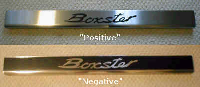

  12. I bought a set of these off EBay and they look very nice on the car. They have a few different versions available and they are nice and sturdy. $75 bucks is better than $400!
