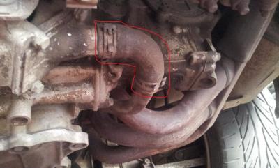

  7. It would be much appreciate if someone can help me find the correct part number for the water hose in the picture highlied in red line. · Model year: 2001· Body Style: C4· Transmission type: 6 speed Manual· Country: US

  9. Thanks a bundle! Now I need to figure out how to get the part over here.
