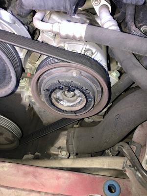

  2. Moving on to the fact that compressor needs replacing, what other AC parts need replacing at the same time? I saw another article stating once the system is opened to the atmosphere, the drier needs to be replaced because the desiccant will no longer remove moisture. Expansion valve due to particulate entrapment. Those extra components don't add too much to the bill but if we go on to the evaporator core we are getting into big bucks. How much is "necessary" to do a reasonable repair?
  3. Thanks for the link. Good read, and I see now that the clutch can be bought separately from the compressor. What would be the final test to check for which component has failed?
  4. Squealing noise from engine bay the other day so I checked location and sound came from area of A/C compressor. I switched off AC inside the car and squeal went away and I was able to drive the car. Today I pulled the air cleaner housing to visually check, and I saw black goo (grease ?, very dense) coming from the pulley/clutch wheel (See photo). My questions are: Is the compressor likely seized and I need to replace entire compressor or is it just the pulley/clutch and that is repaired separately? Are they mated together and only the entire unit can be replaced? Car is a 99 with 98K miles on odometer. AC had been running Ok with no known issue until this. Thanks for any input.
