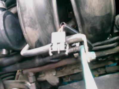

  4. tholyoak - abject apologies!!! :oops: got consumed by finding out the colours of the wires. you're absolutely right - same connector as the photo - brown and red/black! many, many thanks for your help! loren, dr914jr & chris_in_NH - very grateful for your input too! what a fantastic forum. cheers paul
  5. many thanks for the replies.. the engine bay cooling fan seems to be working fine. i have had cause to hear it working over the last few days and no worries on the temp light i think. i'll check the wire colurs as soon as i'm into the engine bay and make sure i find the temp sending unit. the connector looks like a simple optional 12V +/- supply plug with little intelligence but would like to be sure it hasn't been dragged off somewhere it belongs. p

  8. just cleaned the throttle body, etc and used some spray degreaser to try and make things look a little better under there. please be assured - i gently rinsed the engine - no spray or pressure washer!! however, while putting everything back together, i discovered this spare connector on the RHS under the intake manifold and near the engine bay cooling fan. i can't find anything obvious that it has come off of - maybe it's provision for an option i don't have. anyone got any ideas? many thanks in advance thanks paul

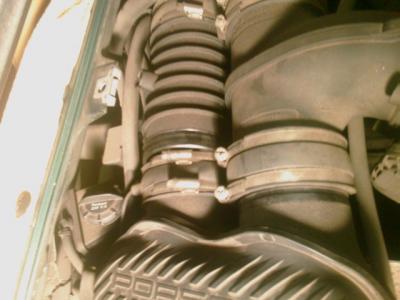

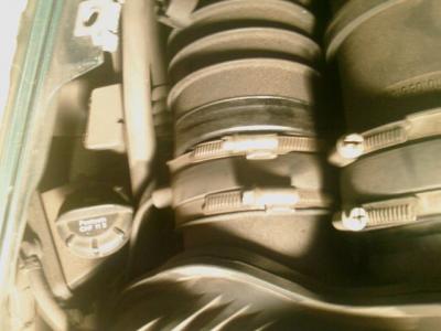

  12. preamble...... took the boxster (2000 3.2s 67k miles) out on an errand tonight - about 5 mile round trip - because the DD bmw was dripping its oil into a canister awaiting my completing its oil change. left the boxster in the driveway so i was certain not to knock it with any flailing tools working on the bmw. finished the bmw oil change, cleared up and, feeling pretty pleased with myself, went to start the boxster and reverse it in next to the bmw. problem...... as soon as the boxster fired up there was an almighty bang followed by very rough running accompanied by lots of "popping" / backfiring!! to cut a long story short, after worrying all over the muffler / exhaust under the car and getting nowhere i opened the top into service mode to try and get a view from the top. i saw that the rubber pipe connecting the two inlet manifolds together had more or less become disconnected from the LHS manifold. additionally, the pipe connecting the throttle body to the manifold was well on its way to being off too. now, i'm sure reconnecting these will be a pretty straightforward task, but does anyone have any idea what caused this and if there's any likelihood of it happening again (on the assumption that reconnecting them returns everything to normal!!). i've attached photos at the bottom of this post.... also, i have a very simple OBDII reader (U480) and it is not showing any codes. i would really appreciate it if someone could tell me how to safely generate a code that i can read and reset to confirm i my reader is actually working correctly (or that i am operating it correctly) many many thanks in advance!!! paul
