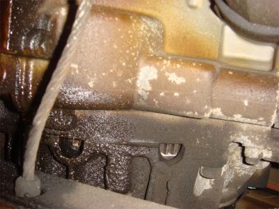

  2. Loren, What is RMS and IMS? And in the photo why does it look like you can see the gears and the metal casing has eroded away?
  3. Hi, I have a 1997 Boxster and today I noticed some oil on the garage floor. It looks like its dripping from about 8 inches right of the oil filter container when viewed from the rear. I have attached some photos, can someone help me with this one? I hope its nothing major, the car has only has 30K miles.
