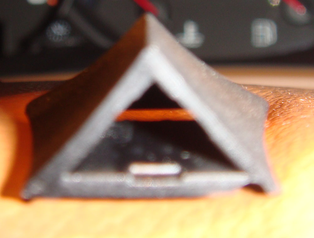

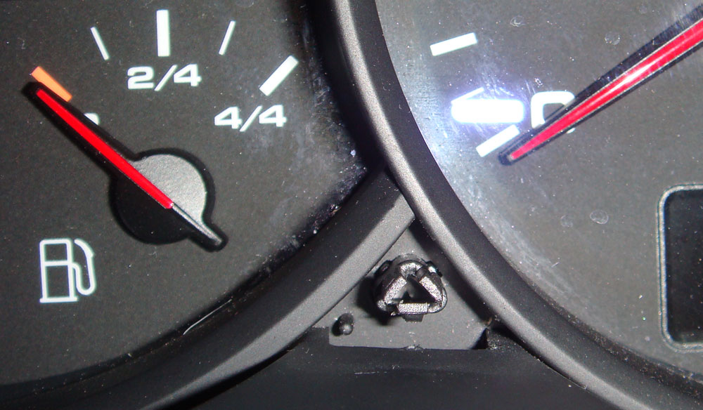

  23. Ok I figured out the problem. I took off Odometer Trip reset button very carefully, you raise the front a little and pull lightly out towards you. Its just a plastic part and picture shows you what the other end looks like. They are suppose to go into the plastic reset button and catch on. I pressed this while the button was off and it RESET to 0 perfectly. So the plastic button's inside groves are probably getting worn out after many years of use, or the fixed part in the instrument clusters groves are not holding tightly. I will get a new button cap from the dealer, can't be more than a few bucks, if it is still a problem then maybe the only solution is to glue it on so there is no free play.
