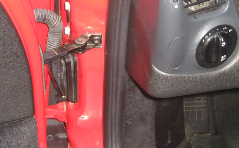

  1. I am trying to troubleshoot the signals from the door switches that are routed through the driver's door and into the car. There is large block connector shown in the attached picture. Is there a pinout available that identifies the signals that are originating from within the door panel ( door micro switches, window power, door lights etc) and to what pin on the large block connector they are terminated on? My central locking system thinks that the driver door is always closed, and is not seeing the signal from the inside or outside door handle micro switch . I believe the problem is in the wiring and not with the micro switches. I am trying to trace the signals, and having the pinout for this block connector would be a great help.

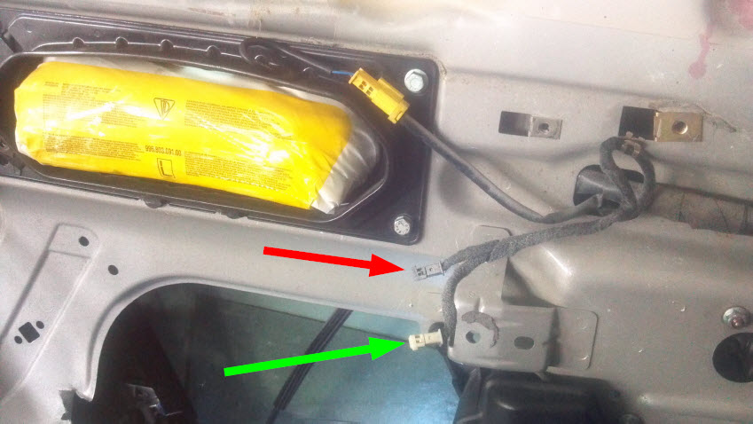

  3. Finally got around to checking color codes of wiring to mystery connector. One wire is brown, the other is red with black stripe. I applied a momentary short across connector and drew a tiny spark.
  4. No LED light in this Boxster S 2000. Also keep in mind the esxtra connector does not exist on the passenger door side.

  6. OK. Just took off the driver's side door panel and took a picture of the inside. Hopefully this picture is clearer than the one originally posted. Notice the airbag is connected so that we can eliminate the airbag from the equation. The red arrow points to the connector that mates perfectly to the connector receptacle at the inside door latch that is secured to the door panel. The green arrow points to the mystery connector in question. I can't find any mating connector for it on the door panel. I am thoroughly baffled.

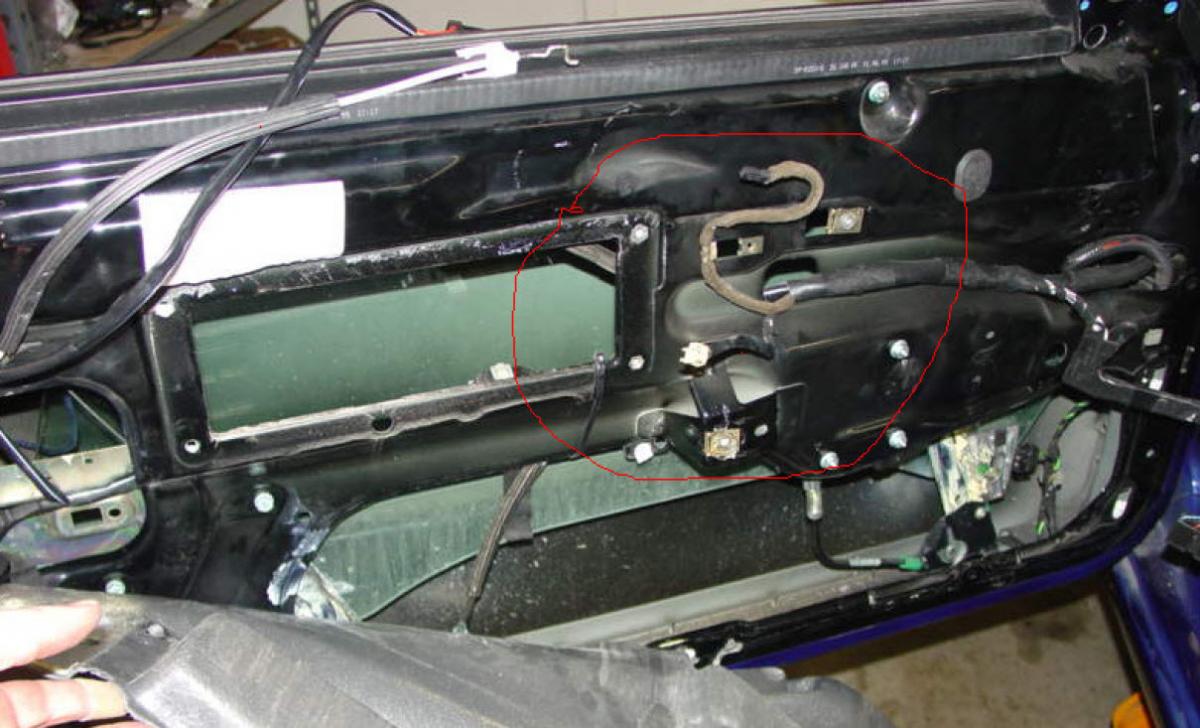

  8. No fun getting old. I recently replaced the window regulator on the drivers' side of my 986 Boxster S (2000). That went fine. However, when I was putting back the door panel, I noticed that there were two connectors that were coming from the door and I could only find one mating connector ( inside door pull handle) to mate. Where does the other connector hookup to? I already connected the connector that was going to the airbag. I have removed the door panel several times for other repairs, but I just can't remember where that extra connector goes. I have attached a picture of the connector in question. Thanks.

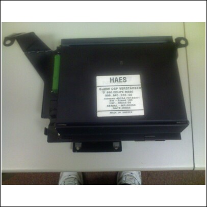

  15. I need some help trying to identify the part numbers and/or locate a pair of female mating connectors (20-pin and 18-pin) for a 996.645.312.00 HAES M680 6x40W DSP amplifier that I purchased on eBAY. My Boxster 2000S that I purchased has the wiring connectors chopped off the harness in the trunk area, so I am trying to restore it to its original setup. The head unit is the CDR-220 with a DSP control panel. Any help would be appreciated.
