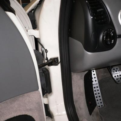

  23. Here is another option for anyone looking more ways. I put my GPS antenna on the outside of the windshield. And then tucked the wires underneath the rubber seal, tuck it in far enough, the wire should sit in there perfectly and should be unnoticeable. I have a couple pics here. 1 pic is of where I have it seated and the other pic shows how I routed in the door hinge area.

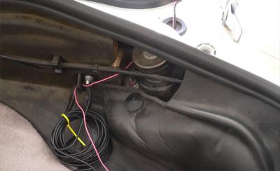

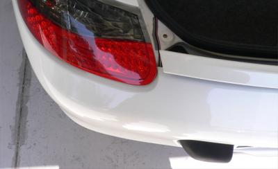

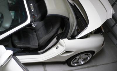

  24. Hi, I bought your AVIC Kit on EBAY. I am about to install it but before I do wouold you mind telling me how you installed the camera on the rear bumper? Where did you find the hole to pass the wire through? How did you get th wire it past the enegine compartment and into the cabin? Thanks' John Hi John, Thanks for buying the Kit by the way. My brother and I are very appreciative of everyone who has contributed to this thread and folks like yourself who gave us a chance and bought our kits. As for the Camera, sorry for the long delay in getting things organized. With the camera installation, you can actually do it in the order below or in reverse steps and it works fine. Hopefully, it's helpful! Step "Prestep". Raise your Spoiler, Open the trunk, and Put Your Convertible Top in Service Position Step 1. The License Plate a. Remove your license plate, should be a hole behind there thats about an inch in diameter or slightly bigger b. Take the detachable wires that came with your camera and loop it from the corner of the spoiler down to the hole behind the license plate. I used a clothes hanger and taped the tip of those wires which is the plugin jack and pushed it through until I could see it located at the hole. Then I plugged in the camera. Step 2. The Trunk a. There is a bolt at the top left corner of the spoiler which I used for the ground wire. Ground it there, 1 less wire you have to route to the front of your car. b. Route the remaining wires (should be the video rca cable and the positive wire to power your camera) along the outside of the trunk space. Hide it under the rubber gasket which lines the perimeter of the trunk. Step 3. The Circular Rubber Gasket a. Remove the rubber gasket located at the top left hand corner of your rear trunk hood. b. Pierce a hole through it and pull your wires through it. Step 4. Above the Engine Compartment a. Now you should be on the engine compartment side b. Route the wires along the side of the engine and avoid routing wires in areas where your wires may get pinched from the moving parts of the convertible top. Step 5. The Door Area a. Tuck your wires underneath the rubber lining that runs around the area where the door is located Step 6. a. Bring Video RCA plug to Avic b. Plug in Positive wire to an available fuse Here it is in pictures:
