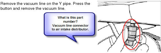

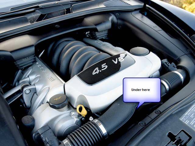

  17. 2004 Cayenne S US model Under the black Y-pipe between the air filters and the throttle body is a vacuum line connector. I managed to snap off the plastic side tabs when trying to disconnect it. I would appreciate the part number as Porsche Downtown LA could not find it for me. Thanks!
