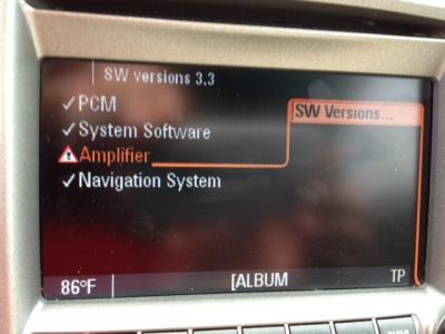

  2. Looks like the GPS antenna was unplugged, I'll report back if that fully fixes the problem.!
  3. I show 0 sattelites in the Status menu. Did a system reset and still the same. I'll take a look at the GPS antenna. Anyone know where the GPS antenna is located?Otherwise I'll Google it.

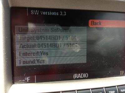

  4. I recently acquired a mid 2006 997S Cab. Everything works great in the head unit, Sound system, etc. The navigation, However does not. It has what appears to be current, software. The problem is...it appears to be stuck on the Previous owner's location in San Diego. It doesn't update location on the map. I, unfortunately, am in Florida. I checked to software and it shows a fault triangle for the amplifier?? Here's the pictures... Any ideas of where to start? I've heard incorrect amplifiers causing issues. But I have working audio? Do I just need the update CDs, to correct the problem?
