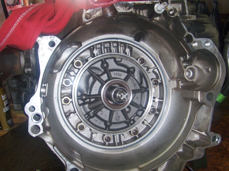

  5. Just came back from the shop to bring some pictures.

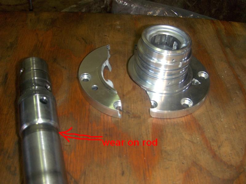

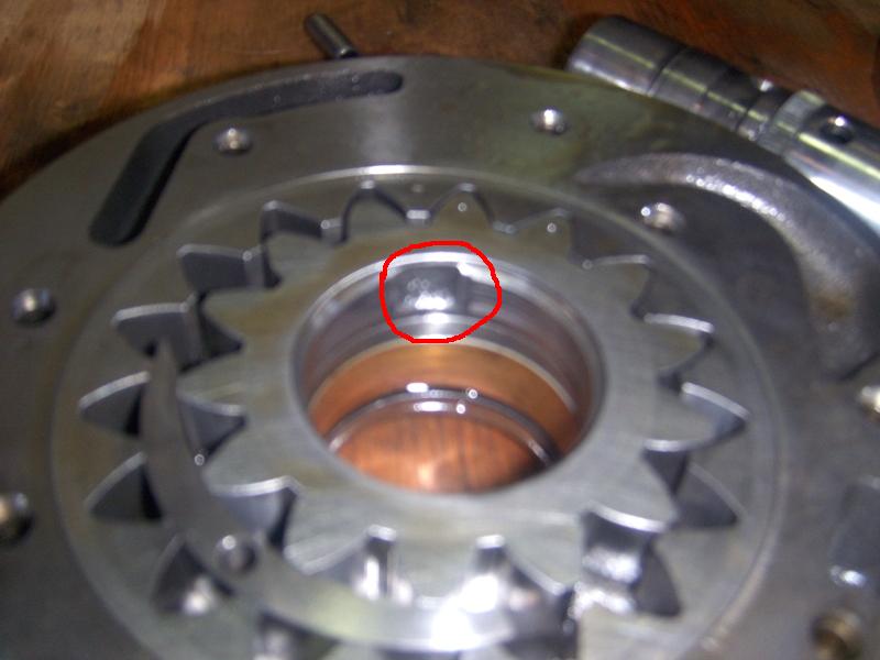

  9. Update - mechanic just called me to let me know that the Oil pump in the trans gone bad, one of the gears broke inside. i will try to get pictures He also told me he called porsche for parts but what they told him is that they dont sell the parts for this trans. aside from the front seal. how can i get the pump ?? Thank you

  11. Ok so more info from today. Went to the mechanic and asked him if he performed a Tip diagnostics , he said he did but no codes from the Tip. Further more , After clearing the codes and kicking the car into manual mode the transmission would shift the gears no problem from 1st to 5th and down. So the trans shifts and The tip works just fine, yet no power to the wheels. The trans is going to be dropped in the next few days, i will try to take pictures for you all.
