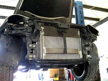

  1. Just some words of experience or wisdom for you. I have had A/C issues for 1 1/2 to 2 years now. Neither the Porsche dealer or a local indy A/C guy could figure it out. Dealer did a scan and swapped the A/C control unit, I did some servo motor work etc. My intermittent issues: 1) freon blow off 2) warmer on passenger side 3) Never super cool on the driver side 4) Coolant temperature slightly warmer I decided to replace the compressor. The indy A/C guy insisted I replace the A/C dryer as well. Upon removing the dryer he found that the dryer failed. Most of the particles in the dryer clogged at the bottom of the dryer and some leaked out into the condensor. They tried blowing out the condensor and put everything back together but I still had the same issues. They felt from that point that the condensor was clogged and not getting an even flow of freon. They replaced the condensor (front bumper and many other parts have to come off). Results: A/C is ICE COLD, no more freon blow off, cold on passenger side, coolant temperature not showing as hot. ******REPLACING YOUR DRYER WILL ELIMINATE GOING THROUGH ALL OF THIS HEADACHE***********

  3. Just a quick update. I replaced the switch and it solved my a/c and fan issues. It seems that my condensor fan was coming on intermittently and causing the a/c to build pressure and blow off freon. The job is not difficult if you have done the coolant pipe replacement. You have to remove most of the same parts. One HUGE help was that I had a 22 mm O2 sensor remover (it attaches to the end of the ratchet). It fit right over the sensor after the connector was removed. Prepare for some coolant to come out so be ready to plug it with a finger or have the new sensor ready.

  5. I had an indy shop replace the a/c fill valve with a new brass one. I had 1 more freon blow off right after that but nothing since. I don't know if the fill valve replacement worked or if the fan just fixed itself. I no longer have an A/C or fan/temperature problem?
