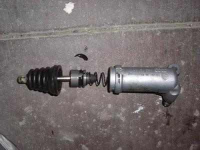

  2. Found that the old clutch slave cylinder could be removed lifting up the rear left on the car and change it without taking anything else apart. I removed the old cylinder and after wiggling it a little, the inner parts jumped out It turned out that the whole inside had been pushed out and during that the o-ring had been damaged - so I suspected hat the arm inside the clutch was not pressing back enough. I bought a new clutch slave cylinder, mounted it but thought that there should have been a little more resistance from when compressing the inside spring. After bleeding the system I could hear that the clutch was working, but only a little. The pedal could only be pressed down halfway... No luck After finding explanations on how to change the clutch on my own and having taken a look at the tools available in my garage, I decided to take it to a friend of mine who is a mechanic for fixing. Bought the Sach's clutch kit and a clutch arm, just in case. The old clutch arm removed, notice the crack - there must be very strong forces in action on the clutch system The clutch disc itself was ready to be changed as well, the fly wheel was not changed but just re-surfaced Also had to change the rear main seal as it was leaking a little. Finally got the car back on the road after 3 weeks in a Ford Explorer - the clutch is so smooth and light that it took me a little time to get used to again, very hard to find the actual position where it engages, but what a joy to drive again :lol:
