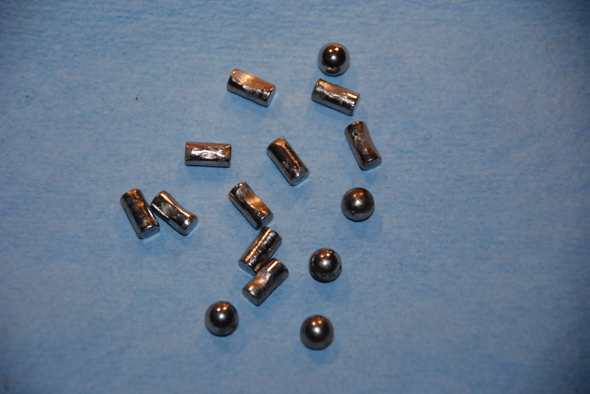

  4. I had the misfortune of having the coolant pump on my 2000 Boxter "blow up". Rattling/grinding noise with big cloud of radiator fluid. Had to be towed home. Found the leak was from around the coolant pump drive shaft and that the drive pully would wobble just by my hand. When I pulled the pump, there were pieces of shredded impeller as I expected but there was also a hand full of metallic cylinders (roller bearings?) and ball bearings. (see photos). My questions are: 1) I assume these were all from the pump - right? 2) Other than trying to flush out the system with a garden hose is there any thing else I can or should do? 3) is there any danger to the engine/vehicle if I don't get one of these bearings out? Thanks, McKinlay 2000 Boxster 2.7L 108,000 miles
