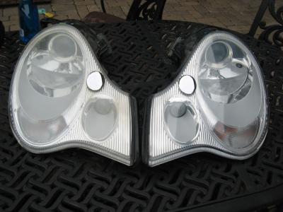

  19. Here is , before and after . This stuff works great i may do it one more time . Any one knows the trick how to remove the headlight fluid washer chrome tips ? :renntech:
  20. so it looks like i should start to send it with 3000 grid wet disc and then polish them . A soon as i am done i will post before and after picks .
  21. If you're thinking what i'm thinking may be your looking for this post: http://www.renntech.org/forums/index.php?s...hing+headlights let me know if correct. B) YES !!!!!!!!!!!!! This is what i am looking for . Will go tomorrow to napa or autozone and see if they still have this kit. :renntech:
  22. my 02 911 was used a lot in Florida. The result of it is ---- mate headlight which does not look good on my car . Is there a way to replace the glass or refinish the headlights ??? :renntech:
