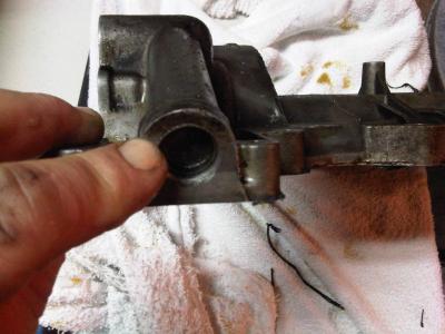

  6. Part number on my AOS is 996.107.023.04 Here is a picture of the port in the block that the AOS fits into. Looks like some leftover gasket material? I thought maybe the oil pump or cam cover was leaking but after I got it in the air I could see the oil was coming from somewhere higher on the block. Very small amount but it drips on the exhaust occasionally. Should I be using sealant on the red rubber seal?

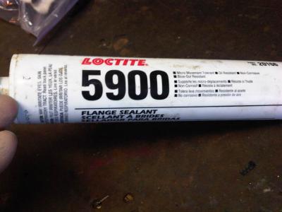

  15. Removed the frost plug, Obviously it has been leaking. Replaced it with an 18mm frost plug from Napa. Resealed cover with Napa copper permatex. It seems to be considerably thicker than the Loctite 5900. This time I removed both blowers from the passenger side and dropped the engine a bit. Made it easier to get the cover back on. Just waiting on parts from Auto Atlanta...o ring's and spark plug tubes. Next time will use Sunset...much faster shipping and cheaper.
  16. Do these little "frost plugs" (for lack of a better term) in cam cover ever leak? After dis-assembly it looks like this one is leaking. Are they available as a part?
  17. Hey all, got a question about cam cover sealant. I have removed my cam covers 3 times and have a persistant leak on the passenger side. I cleaned the surfaces well and used Loctite 5900. Torqued according to the manual and it was good for a few months. Car is stored now due to weather and i would like to get this resolved. This time I am doing it with the engine in the car, but i have removed both blowers from the passenger side to allow more room. Is there a different (better?) sealant that I should be using? Any tips to make it successful? Thanks
