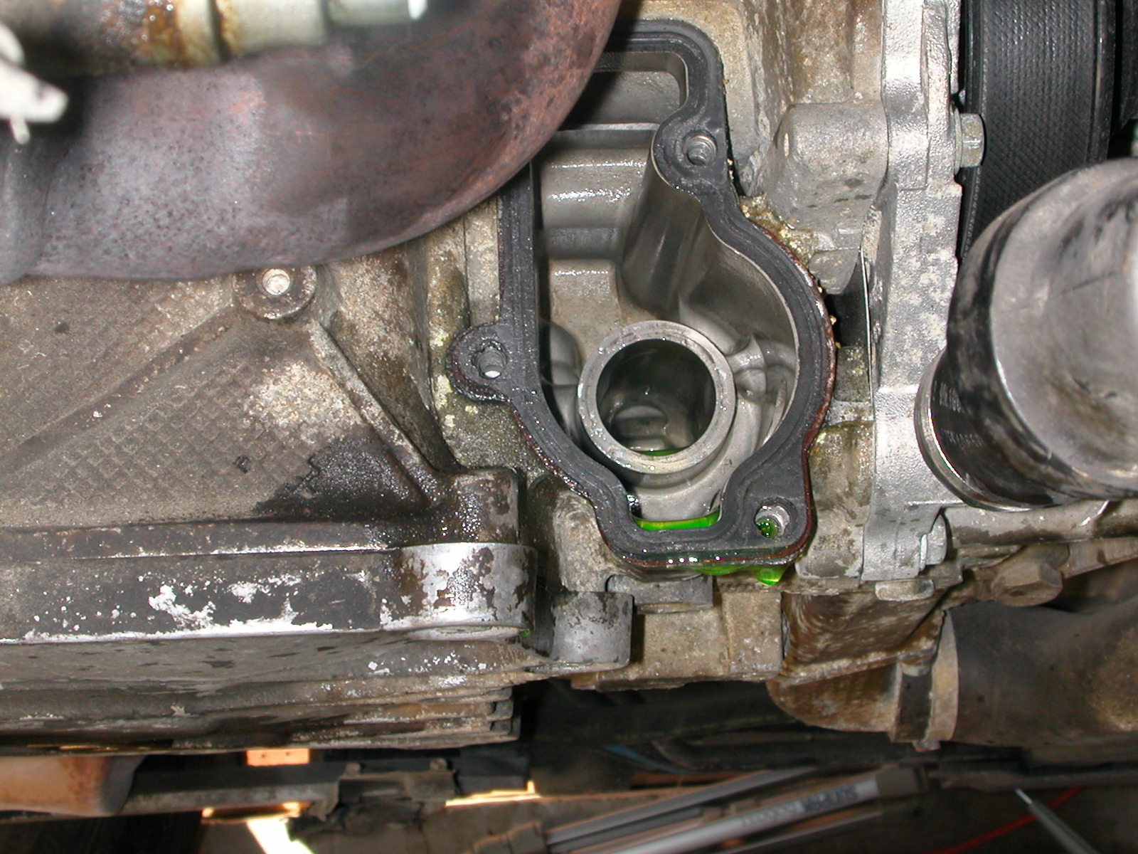

  10. Part should be in tomorrow. We'll know for sure then! Thanks again to all!! ************************UDPATE************************************ Got the thermostat installed today. What an easy process! Thanks again for everyone's guidance! Temperature rose to 180 and stayed with some pretty decent cabin heat. After a quick test run, however the engine temperature stayed at 180 with the engine temperature light flashing. I know there's a thread somewhere where Loren pointed out the 4 reasons the temperature light comes on. Seems like all arrows are pointing to the coolant sensor now. *************** FINAL UPDATE *********************** Added more coolant (to the max fill line) and all is well now. No more flashing light. No overheating either. Still not sure why the thermostat was totally gone, but I'm not complaining. Thanks again to everyone for their input!
  11. This car really has been a mystery as so many things have needed repair when I bought it (motor mount, ignition switch, radio wiring, wheel bearing, control arm, new carpeting due to previous coolant leak, etc). The fact the thermostat was missing almost leads me to believe there is yet another issue awaiting me...like the overheating mentioned earlier. Would an educated guess into the reasoning behind removing the thermostat, lead one to believe there may be a water pump problem too as wvicary suggests? I'm guessing once I get the thermostat installed, coolant levels checked, etc, a first sign of a bad water pump would be overheating?
  12. I can only wonder how much I would've paid the "stealer" for this problem. Just goes to show how this forum, and everyone with porsche "know how" who contributes, really helps out us little guys. Thanks again to 1schoir, rsfeller, Bill_SoCal, and Maurice, who walked me through this issue! You guys saved me a ton of cash! After I get her put back together, I'll report my results and bring this mystery to an end!
  13. Uhhh...can someone please verify what I think I have..or haven't found once I removed the thermostat housing? After searching for a new thermostat and seeing several pictures of what they look like, I was very surprised when I removed the housing and found nothing inside...[pictured below] And nothing was inside the engine either. :huh: This is gonna sound a like a total Noob question, but based on the parts for order I've seen....shouldn't there be an actual thermostat somewhere in housing? Have I been driving without a thermostat? And if so, what kind of damage has been done in anyone's estimate?

  15. Maurice, Great photo. Now I know what I'll be doing when I wake up tomorrow morning. I appreciate the help. I hate to go back to the well too many times here, but can you or anybody tell me if the thermostat is "stuck"....can I repair or do a quick-fix to it? Or does the whole flippin' thing need to be replaced? Very greatfully, Joe St. Louis, MO
