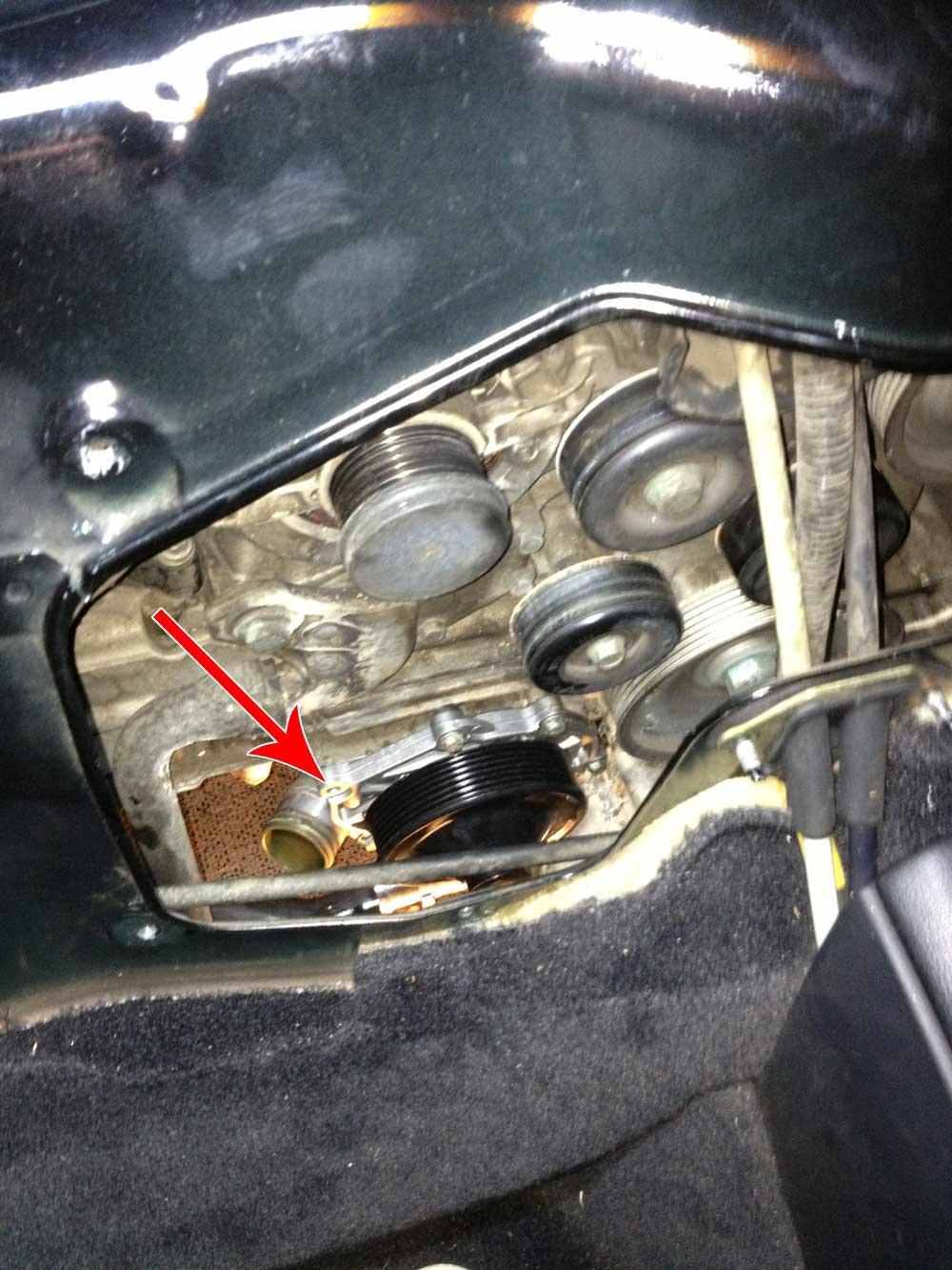

  2. Thank goodness the results weren't as bad as I thought. I decided to take my car to indy Porsche mechanic, luckily he was able to complete the job without having to drop the engine. He removed the front motor mount (which is pretty easy to do). Then he raised the engine a few inches in order to provide enough clearance (from within the passenger compartment) to drill a straight hole into the broken stud and extract it. The stud that broke was at the top of the water pump. If it was was one of the bottom studs that broke, he probably would have lowered the engine a few inches to gain access. If one of the middle studs would have broke, he probably would have had to drop the engine. This is what caused the stud to break - I screwed in one of the longer studs into the shorter stud's hole. There are 7 mounting studs, 2 of these studs are about 1/4" longer than the rest which means the holes the long studs screw into are deeper than the rest. As I was tighetning the stud, it was becoming harder to tighten and it maxed out, next thing I knew, it snapped. I was doing this blind because I was underneath the car, reaching up and tightening the stud at the top of the WP. I didn't have a clear view. I should have went into the passenger compartment and tightened it from up there. It's important to keep track of the holes each stud comes out of when you R&R the water pump.

  4. 1Schoir: There's approximately 5 inches between the engine block and firewall with the water pump removed. There's plenty of room to fit your hand in there comfortably to remove the stud with a socket wrench but I'm afraid it's too cramped to perform a decent stud extraction without messing up the original threads or engine block. I viewed some videos on YouTube on stud extraction. It seems relatively easy however, I noticed that in most of the videos they were performing the extractions on a work bench or in an area with plenty work space. I've decided to let a pro handle this since I haven't performed one of these before. I'm positive my mechanic will want to drop the block but, it would be great if he didn't have to because I know that dropping the block would affect the final cost. I assume he'll perform the following: - Drop the block - Remove the water pump - Stud extraction - Install water pump - Install engine - Flush & refill engine coolant I'll report back with results and estimate.
  5. - 2001, 2.7L Boxster, 5-speed, 94k mi. I broke one of the studs while replacing the water pump. The good news is, it's the stud that has the easiest access from the interior of the car, with the access panel removed. The bad news is, I can tell the stud probably broke flush along the block. I have seen stud extraction tools but I haven't used one before. It seems as though one would need A LOT of working space to properly use stud extraction tools. I'm afraid the best way to tackle this project is to drop the engine for optimum access... which I'm not capable of doing due to lack of equipment and time. Has this ever happened to anyone? If so, is this a job for an average DIY guy such as myself or should a pro handle this? I attached a photo, the red arrow indicates which stud broke Any advice would be greatly appreciated.
