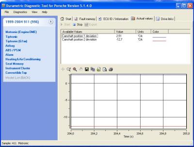

  5. Thank you for the thoughts on cam deviation logray, very interesting indeed! I have read the thread you link to before and it does have some good pointers. The car is running fine with my values, but something is definately wrong somewhere. I'm wondering if perhaps a pad could be worn out on bank 2 (I think the pad on bank 1 was replaced at around 109.000 km, earlier this year) or if the sproket has loosened. Or any of the other things you've mentioned. My car is a 3,6l x51 though, wonder if it changes things. I couldn't find a variocam activation in durametric to play around with, I can only activate the lift and they're both called the same. If I do activate those drive links, the engine sputters to death instantly. This car has variocam pluss though, I presume that might have something to do with it? Would've been nice to be able to test the cam actuators as well, but kind of hard to do with nothing to activate.

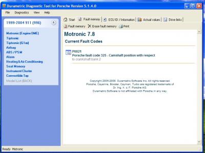

  9. If you have values outside what the car thinks is normal, you'll get an errorcode. P0011 for bank 1, P0021 for bank 2. I'm in the middle of trying to figure out why I have a P0021 myself while the car itself is running fine. Durametric shows a deviation of about -12,7 for bank 2 on my car.

  14. Hello, I really hope someone here might be able to help me figure this out. Recently I got a CEL and drove the car to Porsche locally. They hooked it up and found a few codes, one was P0021 and the other one for one of the lambdas. The tech said the lambda one could most likely just be from the fact that the timing was off. We decided to clear them and see if things got better on their own. The cell hasn't returned, but today I got my durametric cable and was able to have a look in there myself. The P0021 is back, but not the lambda one (hence the lack of a CEL I presume). Some info on the car and milage: Milage at the moment: 115.000 KM New engine: 104.000 km (from a German indy (albert motorsport)) New oil pickup: 105.000 km (about the same milage as the original P0021 first came) New AOS: 105.000 km (about the same milage as the original p0021 first came) New chain tentioners: 109.000 km Anyway, there's something that seems to be a bit off, attatched are some screenshots of actual values while the car was idling tonight. I have a suspicion that the timing is a whee bit off on one of the cams (intake?). As is, the deviation is obviously out of the +/- 6 dgrs range but should only be about 3 degrees out of actual spec on the cam itself if I've understood how this actually works. Also, this is a X51 3,6l if that changes anything at any point. Edit; was a new AOS that was put in at 105k km, I'm not all that fluent in german so had a friend look at the paperwork today and turned out it was the AOS. Live and learn!
