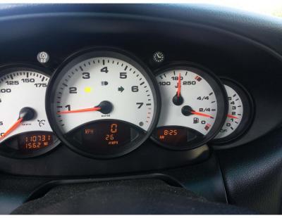

  2. I don't think anything changed after the AOS, I've just been paying more attention to the gauge and it's gotten hotter out. Where is the bleeder valve? I am also thinking about doing the high speed fan switch mod to increase cooling when driving in traffic. Any thought on the pros/cons of that? It seems quite simple to do and I don't see any downside to the method described here http://www.renntech.org/forums/topic/15470-high-speed-fan-relay-hackmod/
  3. I just drove my car again today and activated the OBC readings in the HVAC controls. Temp peaked at 104 for a minute or two but generally stayed around 102. Still not sure how to check for the operation of the fans but definitely want to check that. The water pump was done in the last two years so I'm not worried about that. The temp only spikes when I am in slow traffic and the temperature is in the mid 80s or higher outside. When driving at normal speeds it never goes over 100.
  4. A quick update, took the car to dinner with my wife last night, it was high 80s and humid outside but it was around dusk and there was no traffic. Needle barely moved to the right of the direct vertical position. Looks like my car hates traffic but I am wondering if this has to do with the low speed fans not working or at least not working properly.
  5. I'm going to clean out the radiator and if that does not help think about a lower temperature thermometer, is there anything else I should be considering?
  6. I know the oil is fine, will check coolant when the car cools down around lunch time. There is a tiny bit of debris near one of the radiators, I'll clean it out with my shop vac when I get home tonight. Is this dangerously hot?
  7. I just got the car back after getting the AOS replaced and noticed that it seems to be running a bit hotter than it was last month. To be fair it's also been about 10-15 degrees hotter than it was the last time I drove the car so I'm not sure if I am still within the norm or if I need to address an issue. Two pics of the temp gauge attached. I tried to connect my bluetooth OBDII scanner to my phone in order to get a more accurate temperature reading but it would not pair and I needed to go into the office. I'll try again at lunch.
