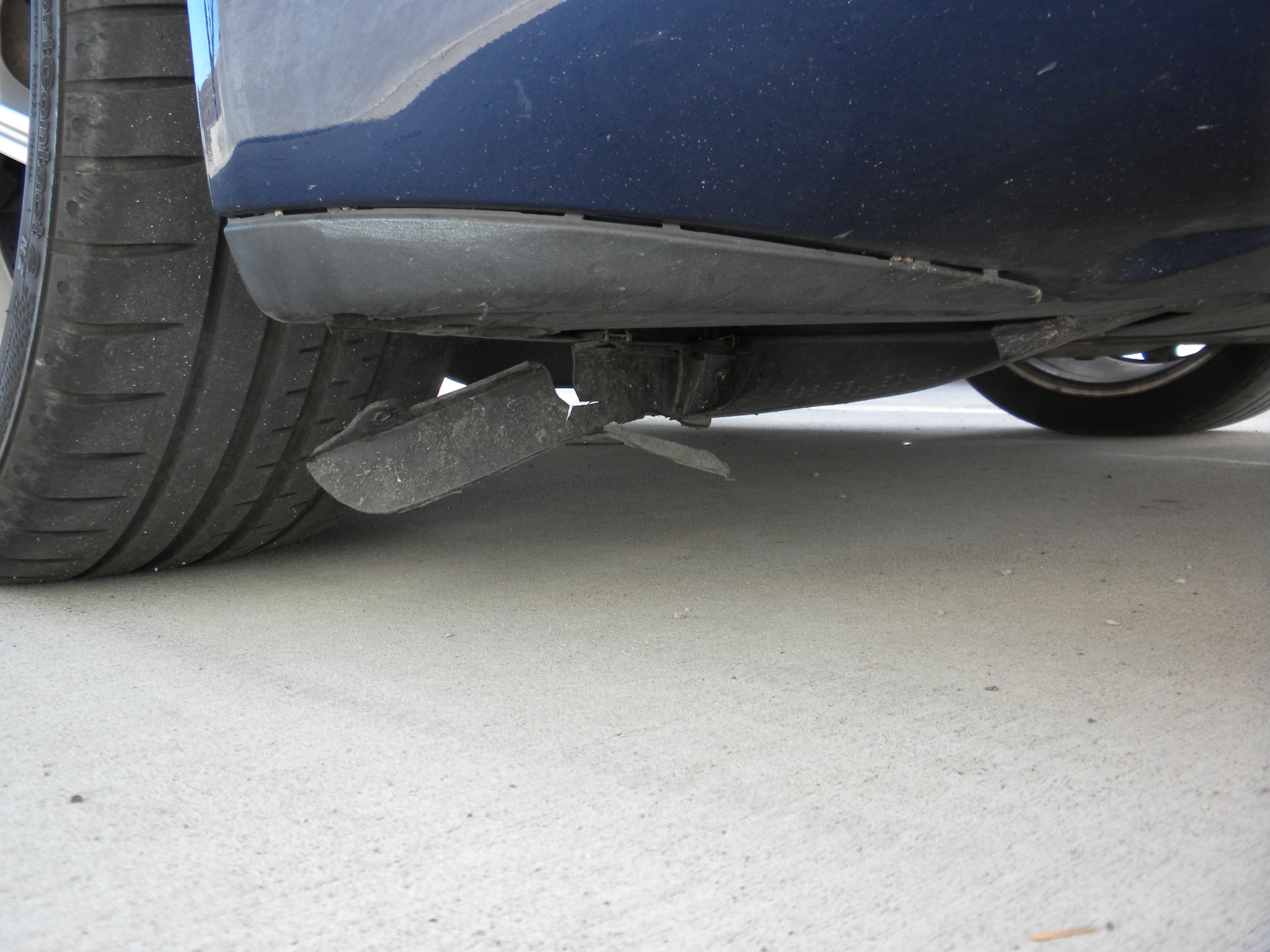

  8. Can I get some help Identifing the following part? This is a little plastic "spoiler" on the leading edge of the rear fender wells located at the bottom. The attached picture shows what I'm referring to. Mine is torn and needs replacing. Thanks for the help Dan 2001 Boxster S

  17. Just to close this out for future reference. Rubber Lip-Passenger Side 996-504-504-00 $14.10 Screw 4.8 999-073-061-02 $ .23 Speed Nut 999-591-699-01 $ .23 Thanks to our friends at Sunset.
  18. Can someone help me with this part identification. The car is a 2001 Boxster S. The part is a spoiler lip? for the passenger side, just infront of the wheel. I'm not finding it in my PET list. I'll also need the associate mounting screws, etc. Here a photo for clarification. Thanks Dan
