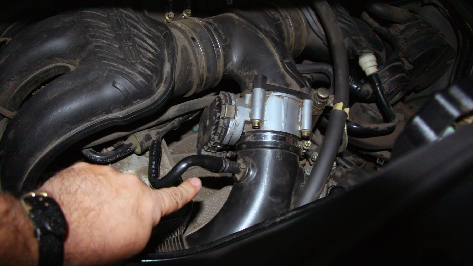

Can anyone help me with this? I see a good number of readers... Is there a trick to disconnect the smaller rigid tube from the large tube entering the throttle body? Appreciate the help... -

A photo would help. If you are referring to the thin rigid "J" tube that is runs from the AOS (Air Oil Separator) to the throttle body large tube, you just have to squeeze the outer ring that circles near the end of that tube and then simultaneously pull back the tube and it should come apart. Regards, Maurice. Here is a photo of my dirty engine compartment. Please let me know what folks use to clean it up. My finger points to the rigid connection point I am having difficulty with. I don't want to break anything. It does not give. Is there a trick to disconnect it from the large tube entering the throttle body? -

I just cleaned the throttle body for the first time on my '01 2.7 this past weekend (yesterday - Sunday). Despite all the discussion on this in the past, I had trouble searching for the procedure for getting to the throttle body and removing it. Here's what I did: Loosened the hose clamps on both ends of the plastic tube [1 in your first picture] running from just past the MAF / air filter box [3] to the throttle body [2]. As you noted, the end [3] that butts up to the MAF comes off pretty easily. The other end that joins the throttle body i[2] s a real pain to get off. I pulled, twisted and wiggled for about 30 minutes, and somehow just got the right combination of moves and it finally came off. My hands aren't that large, but my knuckles are pretty beat up. I found it's easiest to access from the driver's rear fender side. Don't worry about the trouble getting it off, because it's even harder to get back on! I don't think it's possible to get the throttle body off without disconnecting the plastic tube at [2], but if there is, it would probably save half an hour or so. Same comment applies to reassembly. I haven't read about anyone using a blow dryer to heat up the plastic tube at [2] to expand it to get it on and off easier. I was going to try that if all else failed after a few hours. Somehow, the plastic tube just came off after struggling for a while. Once the black plastic tube is off, pull it out and set it aside. It was clean on the inside, but I wiped the outside down with several rounds of Simple Green, followed with water to get the Simple Green residue off. The throttle body comes off by unscrewing the 4 long bolts with a metric hex driver. The 2 long bolts on the driver's side have washers, and the 2 on the passenger side do not. Once you have the 4 bolts off, the throttle body is still connected with an electrical connector (e-Gas models), which simply unplugs. Pay attention to the orientation of everything. You'll notice on the throttle body there's an arrow that lines up with an arrow on the plastic air tube (visible in your second photo). Cleaning the throttle body is the easy part. Just keep spraying throttle body cleaner and wiping the crud off. You can push the flap open to get all the way through - it's spring loaded so watch your fingers. I also tried wiping down the tubing on the back side of the throttle body, but it was pretty clean inside (at 51K miles). The only hard part (as you would expect) is getting the plastic pipe [1] back onto the throttle body [2] after the throttle body is reattached. Expect another 30+ minutes of pushing, twisting, wiggling, swearing, etc. I lightly sprayed some silicon spray on a paper towel, then wiped it on the outside of the throttle body and inside of the plastic pipe. Hard to tell if it helped or not, but it didn't hurt. After everything is put back together, start you car and make sure everything runs and the throttle works before closing everything up. When I was all done, I gently re-tightened all the hose clamps since several felt semi-loose I don't think it matters how dirty the throttle body is on the outside for how your car runs! It's the inside that counts. But there's no reason not to clean up the outside when you have the throttle body out Working this as I write this. Looks like it will help as I am stuck. Thanks.

I noticed, while driving my 2002 986 S, 89K Miles, a whistling sound at low or easy throttle. Seems to be while in drive mode only. While at a light, or in any gear I can hear a whistle if I barely tap the throttle. Goes away if I am harder on the throttle. I only noticed this after replacing my MAF Sensor. Sound is more noticeable as I have not put back the fabric over the cover yet. I had a P0102 and replaced the MAF Sensor from Sunset this week. I think I still have a bad "new" MAF sensor as it ran immediately worse and threw. -> P1133: Oxygen sensing adaptation, lower load range, bank 2 -> P1126: Oxygen sensing adaptation, lower load range, bank 1 I went back in to look around for an air leak (visual only) and noticed one of the air filter latches was not attached properly and I snapped it back on. Ran slightly better, much less stuttering, but and I am now getting the original P0102 code with the new MAF Sensor! I am a new owner and had a pre-purchase inspection. One thing noted was Oil-Overfill. Can that (overfill) be the cause and I am seeing a ripple effect? If so I will do an oil change (myself) and look for leaks (air) & such. I am thinking I have 2 things going on, one still being a bad MAF sensor. I will try to isolate that this by tomorrow by disconnecting the sensor. Looking ahead, is R&Ring the AOS a DIY and has that been documented here? If I drain off some of the OIL will that fix my AOS issue? I've only find some bits of info here on the AOS. I am able to remove the oil cap with the engine on idle with no effort. When it is removed, I can hear it constantly "breathe" or suck air in. Is there an fault isolation procedure for the AOS? Will a bad one throw any codes? Frustrating beyond belief. I just wish I can simply drive. Big project going on and I only have late eves and the weekends. Thanks in advance for your advice!
