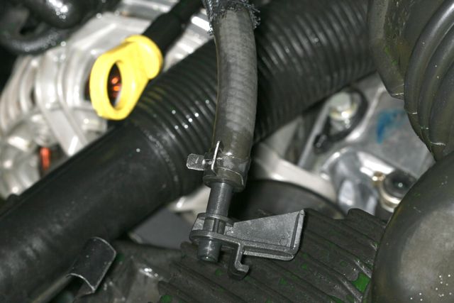

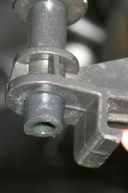

  11. Hi Guys The replacement part showed up at last. I replaced it today. Fortunately it was just a 15 minute job. As a matter of interest, I found a screw that just about fitted into the stuck piece of the plastic pipe (part that was stuck inside the hose) and succeeded in pulling out the piece of fitting from the hose. Next question, and quite an important one I think. My car has the green coolant, the replacement coolant that was sent i the pink stuff. Do I need to drain the existing green coolant completely before filling with the diluted pink stuff? It would be a whole lit easier just topping it up! There was some story about the compatibility of the 2 kinds of coolant though.... Thanks very much for any advice!! Take care Etienne
  12. Hi Thanks for the info. I was wondering how I was going to get it out! Take care Etienne PS: I ordered the part from AutoAtlanta. Pelican has no option on the net for ordering from abroad and the local agent can only deliver the part in 3 weeks time.

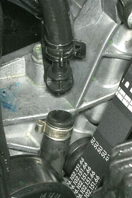

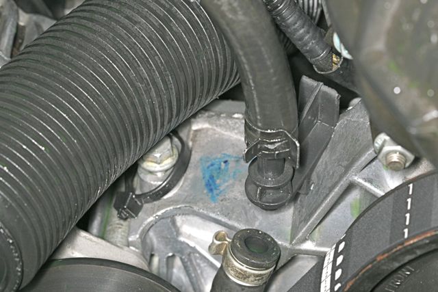

  13. Hi Loren After looking at the diagram closely it seems as if the item in question might be #18, rather than #16. What do you think? See this side-on picture: Would #17, the bolt, then be the bolt in the background with the cable tie hanging from it? If so, should #18 (A 996 106 226 51 - Socket) be bolted down with the bolt in question? Why are there 2 #18's? A 996 106 226 51 as well as 996 106 226 52? Thanks very much Etienne
  14. Thanks Loren!! Anybody know where I could order this part from? Some dealers does not want to send to South Africa... Take care Etienne
  15. Hi Loren Okay, after closer inspection I think you are right, it does seem broken. Sorry for these stupid questions, but what is the "AOS"? Why does that joining piece have such a strange shape? Does that "lip" attach or hook somewhere? So, is it as simple as replacing this broken piece and filling up the coolant system again? Thanks very much for your time!! Take care Etienne
  16. Hi Guys I was on a long distance journey today with my 1999 996 C4 Cab when I noticed the engine overheating warning flashing. I pulled off the road immediately and noticed a lot of smoke coming from the engine bay. After opening the engine compartment I noticed coolant everywhere. My car has done 70 000km, has a full service history from the agents and has had a major service 500km's ago. After getting the car home I noticed that there seems to be a loose connection with coolant coming from the bottom end. Please see pictures attached. Why would this fitting come loose? Is it as simple as refitting the pipe and adding coolant again? I would hate to have to have the car taken to the dealer on the back of a tow truck (400 km journey) if that is all they will do... Any advice please? Thanks very much Etienne PS: Oh yes, what was attached with the cable tie to the bolt?!?
