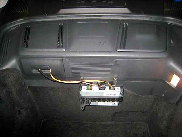

  8. Installed OEM XM kit but I cannot get any input of it on PCM. I have tried all 3 of the available orange Fiber optic cables. Anyone have some possible remedies? Thanks

  10. The seller was quite gracious about my Mistake. His ad clearly stated for Bose, but I got wrapped up in what version of PCM it was and looked past it. He has cancelled our transaction at full refund, and I ship it back to him. A shame it really worked and looked perfect. Now I want one even more. The install itself is pretty simple. If you are in the market for a PCM 2.1 with Bose, check ebay. It and the seller are a winner. Thanks for the comments. Still looking...
