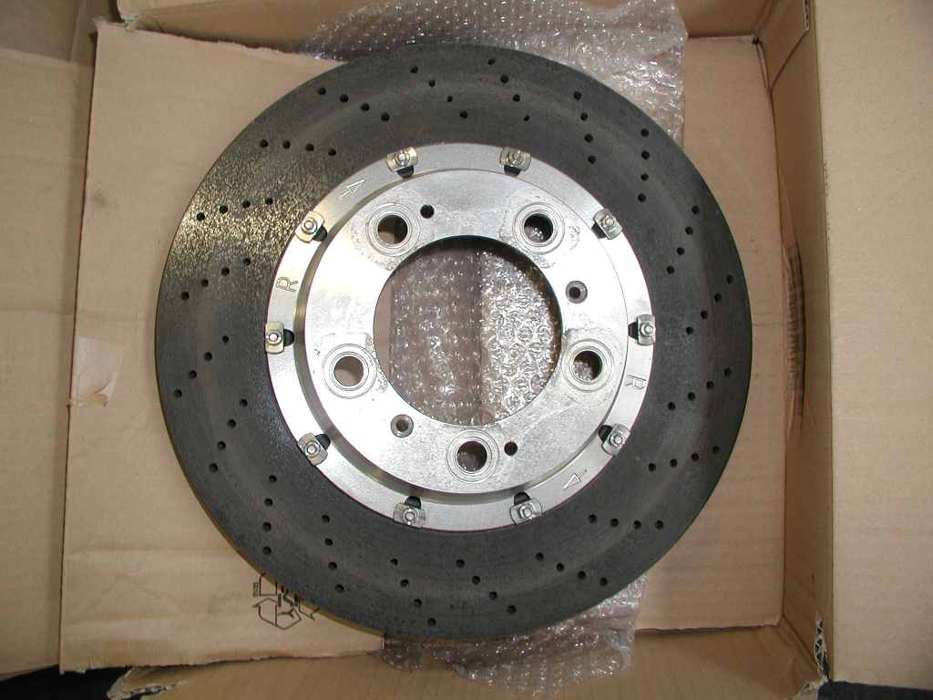

  6. Hi GT2IAN thank you for your answer. Meanwhile i have been told that when they look like this they have to be exchanged cause they could disappear in a dust cloud.... Not really a nice though. About your front discs, you said you got new one's. Can you tell me what part number you got? Even there I know that there are 3 different part numbers, ending with 2 (1.gen) 3 (2. gen) and 4 (3. gen). Apparently this final number differentiation is valid for front and rear discs. Thank you boldis
  7. Hi all as some of you probably already know i own a 996 GT2 MY02. I buyed this car short time ago and was not fitted with PCCB Brakes. The previous owner changed to steel (and destroyed even that) so that I had to change all disks and pads. Now the car has new steel discs and Pagid pads. But personally i think that due to the fact that all GT2's had PCCB on stock, mine should have it too. So i searched and searched and at the end I found a complete brake set on Ebay. The price was OK so I took it. Having zero experience with the PCCB discs they looked OK to me, so i was happy. Now, after some looking at them I found out follwing: The front discs are the newest available from Porsche, 3. Generation and look ..... let's say OK. The rear discs are Generation 1 and look... ugly. I tried to post 2 pics, hope you can see them. Are they ready for garbage or still usable? Thank you Boldis
