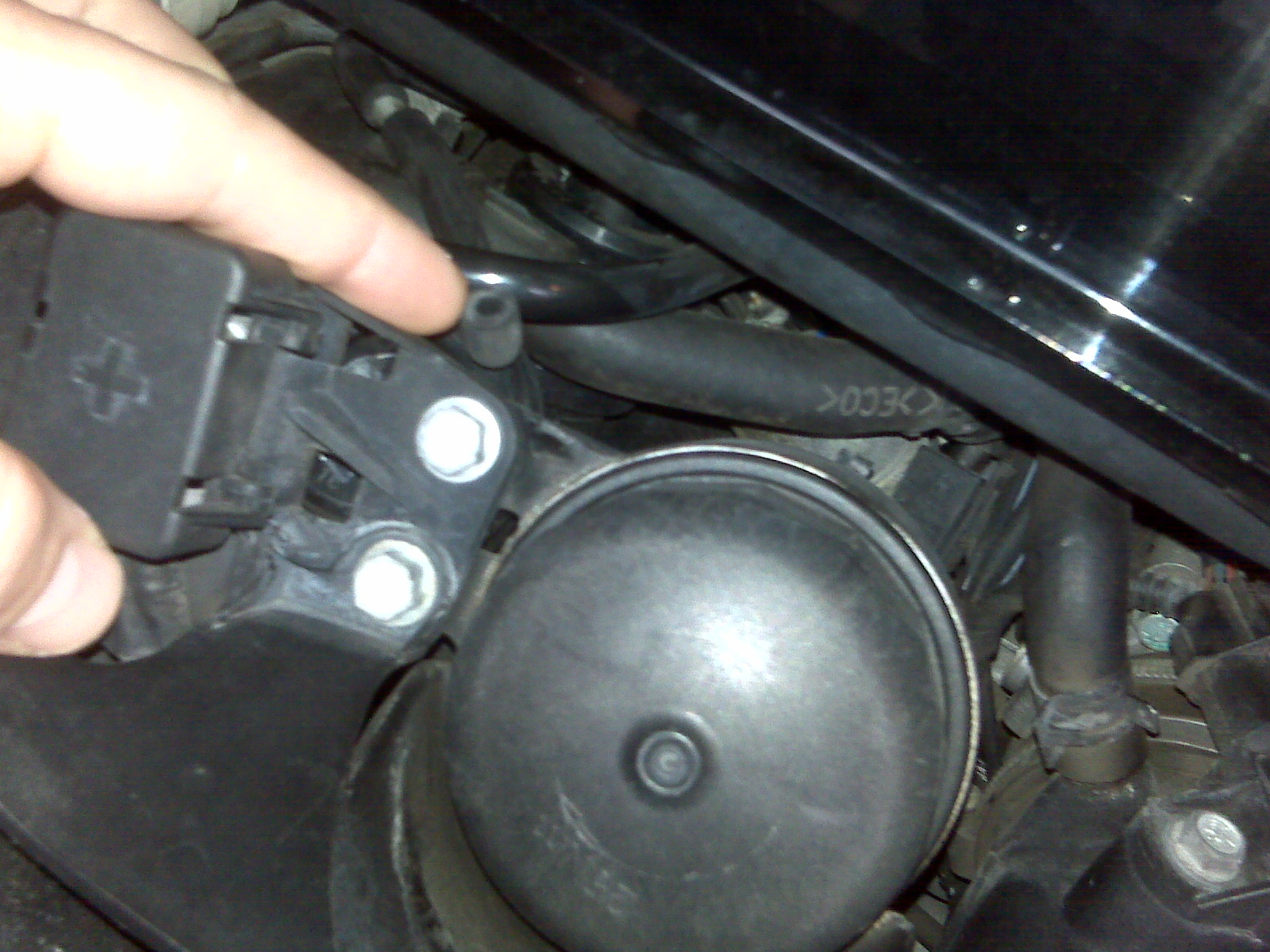

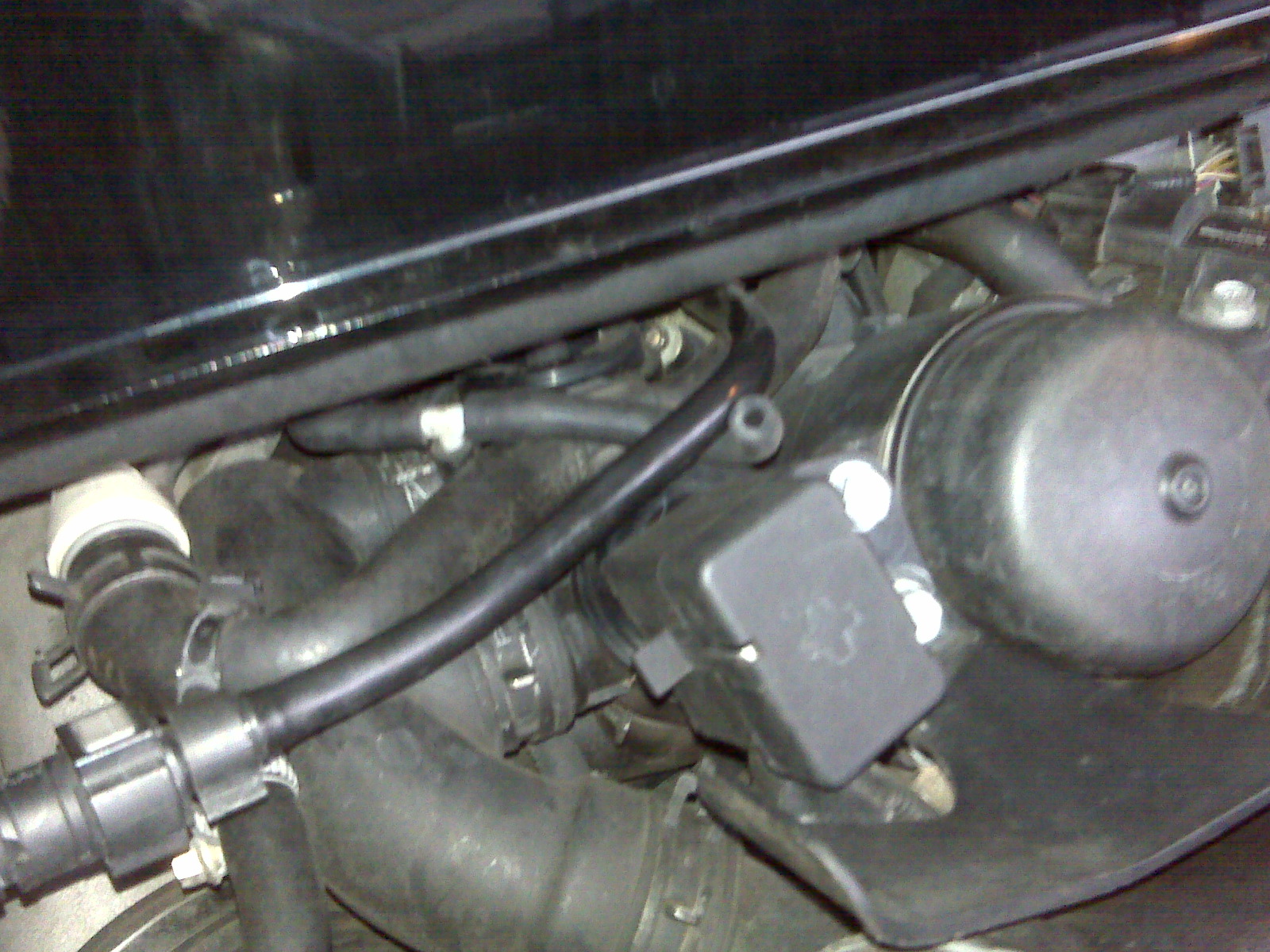

  8. Loren, Understand that those codes have nothing to do with MAF, but I watched these guys do an inspection on my car and they were testing these lines (the one that is disconnected in the picture) for leaks (I guess). I am assuming they never reconnected it and that is what is throwing these codes. I am just not sure where to plug it back into.
  9. Here is anoteher pic
  10. I just replaced my MAF a few days ago and within 5 hours had a CEL with P1411 and P0410 codes. I have searched and gone through ever post related to this. In doing that, I noticed something that just didn't look right. Pics attached. Can anyone tell me what this small hose is and if/where it needs to be attached? Could this be the cause of those codes? Would this cause the car to go into limp?
