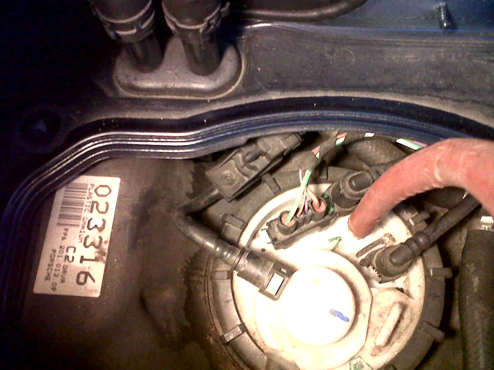

  5. Thx everyone for the ideas. This was the problem: when I removed the fuel sender to replace the fuel pump, I saw that the two hoses (from fuel pump to sender) where disconnected from the fuel sender. They were sort of on but not clicked in and very loose. That would cause all the symptoms I've been having. I replaced the fuel pump anyway and made sure the hoses clicked in. car started right up. BTW: I had to make a special tool (equivalent to VW 3217 or whatever) to remove the plastic fuel sender retaining ring. I don't know how the heck you folks get it off without that tool. Banging it on the edges didn't work for me.

  7. Hi. In the upper left corner of this pic. It seems to be some sort of valve? I think it even has a electrical connection on it? fuel pressure sensor maybe?
