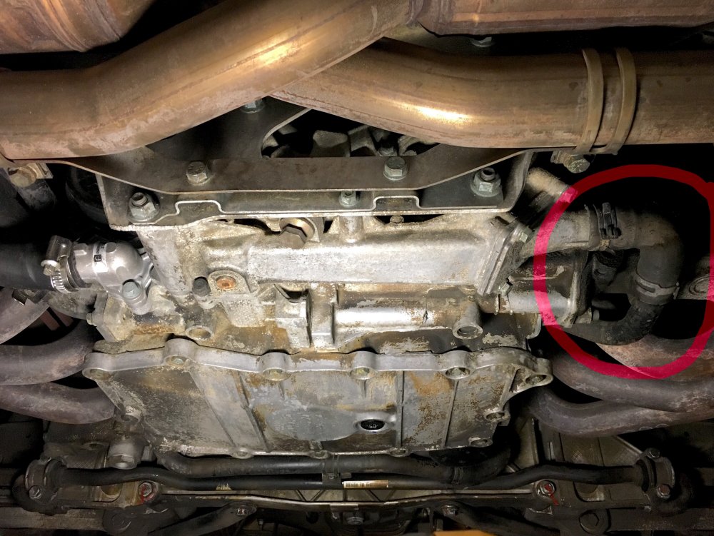

  4. I had the water pump replaced a year ago but just noticed the hose encircled in red (attached photo) doesn't look very good. I'm planning on replacing it as soon as the part arrives. How much coolant should i prepare to lose when I remove the hose? Thanks in advance.
