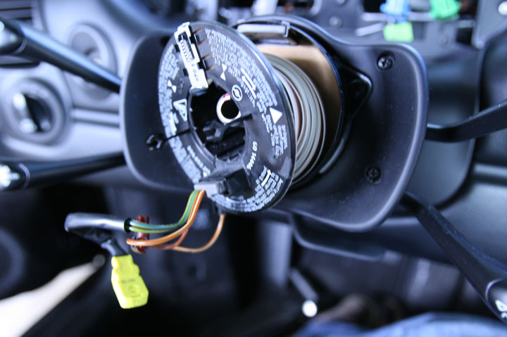

  8. Just an update to wrap this up. Push the top back into place and it is functioning as normal -- though I have to re-calibrate the clock spring. The cause is probably because I forgot to take off one of the cable before pulling the wheel off. Good thing is that the coil and connectors are not damaged. The horn still works and no airbag light-up afterwards.

  10. See attached photo. The instructions I have with removing steer wheel is to tape the clock spring to avoid it rotating......I now know why.
  11. Just to be more clear on what I mean by loosen, the top cover of the clock spring came off. Still figuring out how to put it back and whether it is reusable at this point.
  12. I was trying to get the steering wheel out and it was fitted too tight and I pulled too hard to the point where the airbag spring unit sprang out. Does it mean I will have to replace the whole spring unit?
