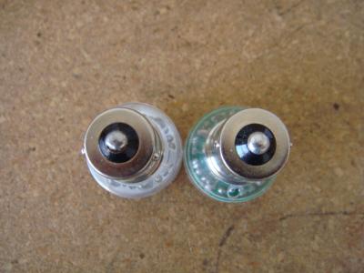

Let us know if you purchase them. From Superbrightleds.com the 1156 and 1157 LEDs are not near as bright as the OEM bulbs. The peanut sized bulbs are just as bright if not brighter. Also, from what I have read about the V LEDs thier 1157s are actually isolated circuits. They have multiple color LEDs for turn and tail light applications. All in all the V LEDs look to be the way to go but at a premium price. D. -

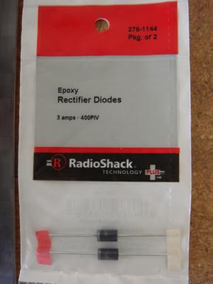

That would work really well on AC... ;) D. It also works well to make the LED bulb non-polarity sensitive, as in the above case. Thanks for the update W. :) I thought that a rectifier bridge was used to change AC to DC by stripping off half of the wave... but I guess what you are saying does make sense even though I wish I knew where to shop for the right LEDs. I figured they were all made the same. When I spoke to superbrightleds about this problem they did not have a solution and did not know of the issue entirely. Maybe I bought cheap 1157 LEDs as I found mine on eBay... In either case if it is not too much trouble can you send a schematic for a full wave bridge rectifier that you describe. I am somewhat familiar with circuitry but I need a visual to understand it entirely. I would like to compare your schematic to the actual 1157 LED schematics for future reference. Thanks again, D. V-LEDs on ebay. Thanks I checked out V_LEDs and they make a premium product, deffinately the way to go but very costly. They're 1157s are actually electrically isolated. I did some researching and it looks like the bridge rectifier is actually used to direct current in one way so the bulb is not polarity sensitive. D. -

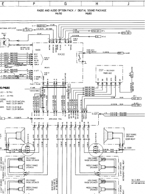

Thanks Loren. On the connector sheet its in the door grid (d7, k7). Does this mean that the wires connect to the speakers and then plug into another connector in the door? Aren't there connectors under the dash. D. :huh: -

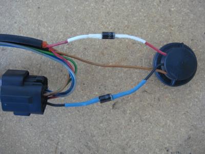

In addition to the 1157 delima there is one more note I should add. If you are not familiar with LED turn signal installations this is a must read. The factory turn signal flasher requires a certain load to operate at normal timing. LEDs require about a 10th of the current that OEM bulbs require and this causes your lights to flash as if a bulb were out (rapidly). It is very simple to fix this problem by simply replacing the factory relay with an LED relay. Here is a picture of the parts required for the turnsignal instal. Take note that the rear bulbs are 7507s while the fronts are 7506s. It is easy to find the amber 7506 bulbs as they are a standard 1156 single element replacement. However, not all suppliers have the 7507 LEDs which have a different bayonet connector. I also attached a picture of my OEM rear turn signal bulb with the orange paint falling off. -
After a long decision to change all of my factory lights out with LEDs I came across a small dilemma. The tail and brake lights share an 1157 dual filament bulb. When installing the 1157 bulb the tail and brake lights would not work independently. I pulled out my multi meter and discovered that all of the light circuits in the Porsche are negative reference. Effectively this means that when a light is turned off its positive lead returns to ground. On 1157 LEDs the two stage brightness is accomplished through two series of resistors attached to the same circuit of LEDs. When 12v is connected to one lead the light is brighter then the other lead, however they are interconnected. When the tail light is turned on a 12v signal is sent to one of the 1157 leads (for low intensity). However if the brake is not depressed, the other lead (for high intensity) is grounded as well. The grounded lead negates the circuit and the light will not operate. There is a solution through the use of two more diodes. I have attached pictures to visually explain the install process. As a final note, the diodes are directional, make sure to install them with the silver stripe towards the socket as I have. D.
