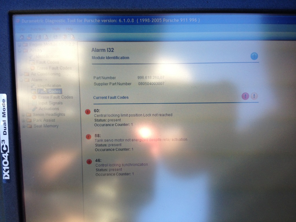

  5. Recently I discovered my drains were blocked and the carpet was soaked. I fixed the rear drain and currently working on the front drains. Having an odd issue. 1. Interior lights don't work. 2. Lock button on the dash not responsive. 3. Key fob not locking or unlocking the vehicle. ( result in two beeps) 4. Manually locking the vehicle with the keys result in two beeps and only the driver door locks. I ran my duramatric and I get the following error message. Fault code 46, 58, and 60. I took the alarm unit 535 and saw green oxidation on the bottom of the board. I hear the relays clicking when the remotes are clicked or the dash door is depressed. Couple of questions. How do I clean the front drains? How many drains are there in the front? If I need to replace the 535 unit what else do I need to get from a used 996. I see comments about DME, immobilizes pill, remote control. Any help is really appreciated as I will need the vehicle in a couple of weeks for a wedding. Cobracars.
