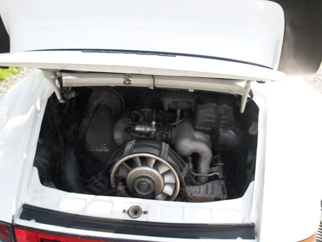

  4. I did find the DME Control Unit (911 618 111 05) under the passenger seat...
