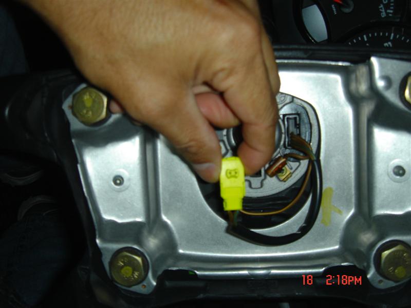

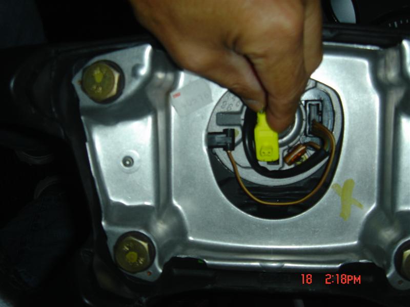

  3. Anyone know which way the yellow air bag electrical connector fits back onto the back of the air bag housing? The connector fits both ways, as shown in the two photos with the lead in wire coming in from the top and from the bottom, but which way is correct?
