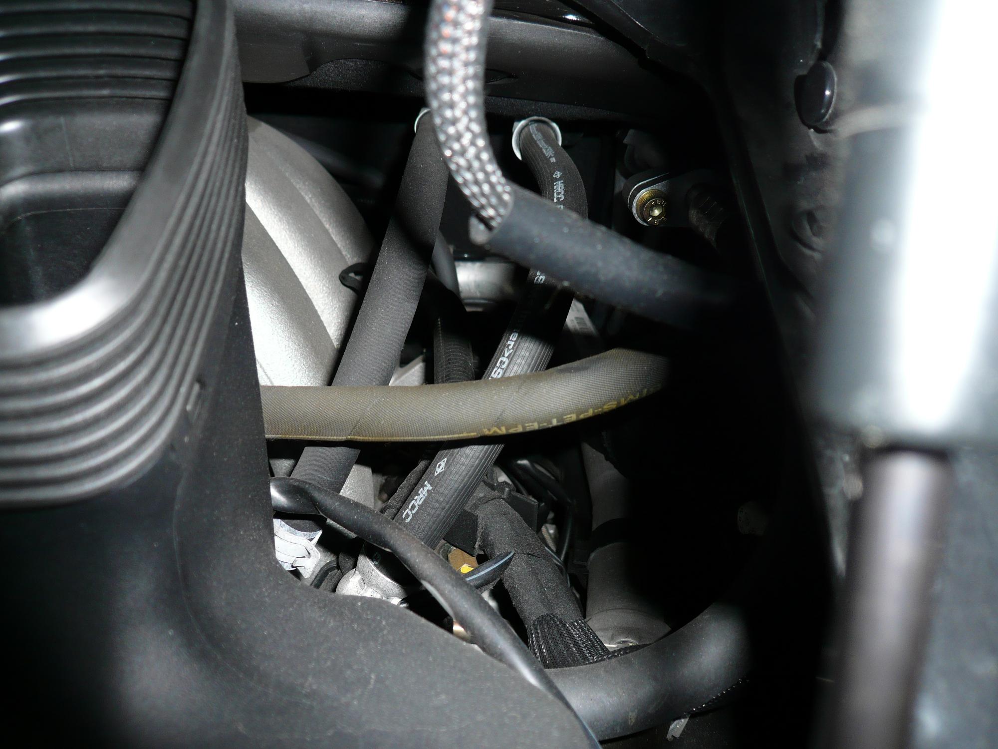

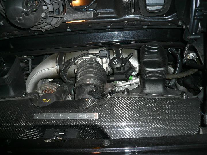

  9. Sorry to be a pain but I looked and I looked and I really couldn't find a grey connector like the one in your picture. I took a few pictures of the area behind the right air box the best I can (you know how spacious the engine compartment of our car is) and I hope you or someone can make some sense out of it. Please :help: !! Marc
  10. Thanks berty987, For some reason I thought I was looking for a brown connector... :unsure: I will have a look and see if the air duct is blocking it. If it is there can I just pull it to disable it? One more thing, PSE does not switch off at 20-40mph for me. When its on its on and when its off, its just off. But I guess that really makes no difference right? :cheers:
  11. Hi phillipj, What do you think? I also looked around and nothing really resembles that brown little connector that was shown. But it was kinda dark at the time so.... Any help is much appreciated. :cheers: Marc
