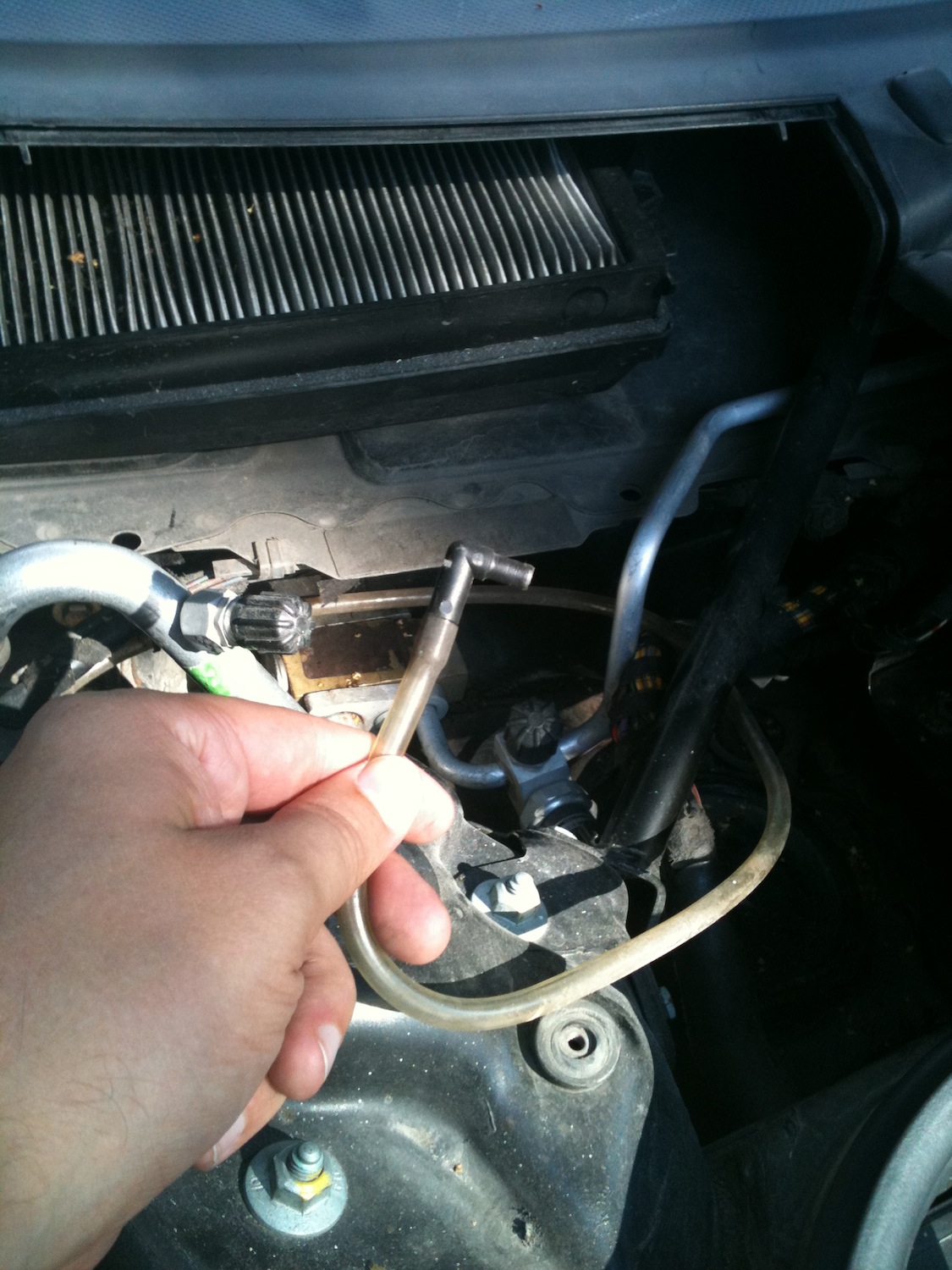

  4. Hi all, I found this little hose unattached from the other end in the gasket near battery, on the passenger's side. What is it and where should it be connected? Car is 1997 986, US-model. Thanks!

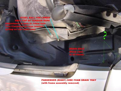

  5. I am still trying to sort out my annoyning wet carpet problem. I have noticed that I get water in from different places and one of them is B-pillar. I have been reading through the previous posts and found this picture, I know it is from 987 and I have 986 but it looks quite the same. I marked my missing part with green arrows. It looks like a seal in the B-pillar? Is it that? Anyone help with part-number? I have tracked one of the leaks to that specific place. Some of the water goes under the soundproofing foam and from there under the seat instead of the drip pan. Thanks in advance!
