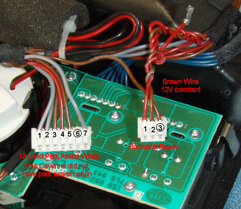

  2. I had the the same problem when I added the Homelink components. The Red #3 wire was not hot. My Cayenne did not have the park assist option so I used the hot Brown #6 wire from the unused Park Assist connector.

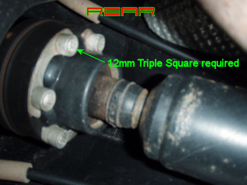

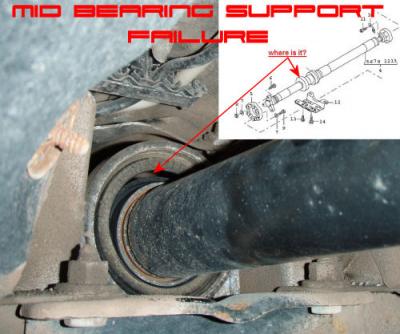

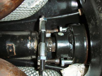

  5. My '04 cardan shaft just failed at 62K miles (Pic shows failure) . I removed the front end of the shaft from the transfer case however the rear part of the shaft seems to be locked into the rear diff shaft and won't move. I removed six 12mm triple square bolts but the shaft just will not pull out. <_< Please help! I've used a hammer, pry bar and come along all at the same time and it still wont break free. UPDATE: It finally broke free when I used a bearing puller from Harbor Freight and long 10mm bolts. The rebuilt unit from Coloradodriveshaft.com is much more robust when compared side by side to the VW/Porsche shaft mid bearing. Shaft cost $450, bearing puller $30.
