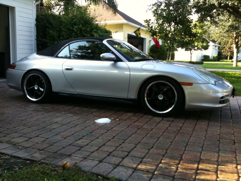

  2. It is an 02 C2. No new mods...The flaps are cool, thanks for all your effort on this. I have read every concievable link on this site regarding top malfunctions and what seems strange is except for the low fluid levels everyone seems to have just a slightly different issue with slightly different symptoms...DWPC's idea about the overheated motors sounds like an answer, now I just need to figure out which %^$*#(@ one it is :) Anyone have any idea before I just start replacing em' all? On another note, I am about to replace my fourth HID headlight. I found the DIY link on this recently and decided to "DIY". After looking at the bulb I could not believe that this thing could cost $250 a pop so I googled it and found them ranging from $60-$100 each. I understand dealer markups but this seems unbelievable... They claim to be the same exact bulb. Has anyone purchased these? One last question...I bought side skirts recently, they came unpainted in a matte black. My intention was to paint them arctic silver to match the car but after mocking them up the black looked interesting. The vast majority of those I asked really liked the black. I am really on the fence about it so I figure I should ask the experts... Pics are attached...thoughts?
