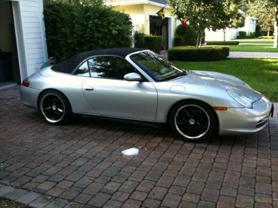

  7. 2002 996 Guys, hope you can help. I am having a problem with my top that similar threads have addressed yet with some minor differences which seem to be pointing to a different kind of fix. (I have already topped up the hydrolic fluid by follwing the process in one of the treads...excellent instruction). Steps: A.) Either by the key or the rocker switch the top starts to open and and completes the close but the lid does not finish it's closing. At first I would just giggle the lid a bit, hit the button and then it would finish the cycle. It would go weeks without incident and then start up again. B.) It is now at a point where once it is at the "Lid stuck" point it must sit for at least 15 minutes before it engages again and finishes the cycle. This is why I thought the fluid top up was the answer, thinking it needed time to "collect". (This seems to be the problem that poster "Izzy" had). C.) If I hit the rocker switch before I give it time to sit I can hear a faint click coming from the rear that matches the rocker switch "click". What seems strange is that it doesn't make sense that waiting the 15 minutes would aid an electrical problem... Forgot to mention that it only occurs on the down cycle. Any help would be greatly appreciated! Cheers
