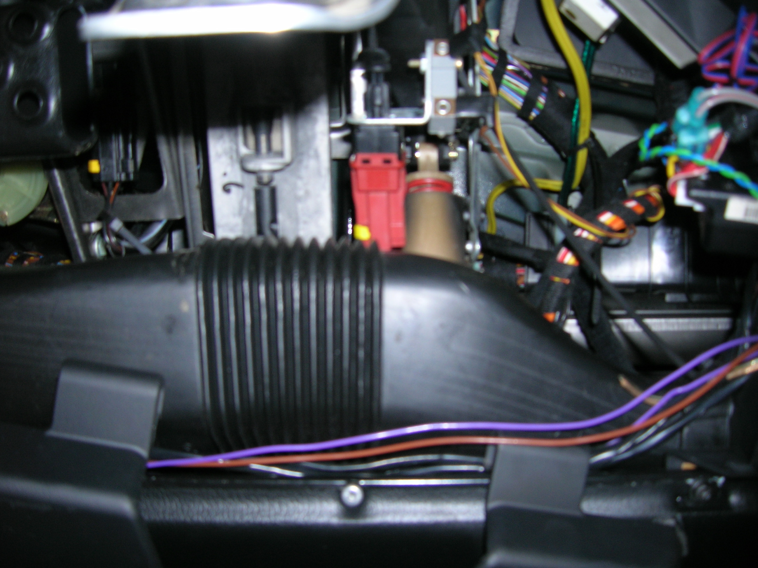

  16. No. I held the switch down...It cranked up.....what I did find was the the clutch pedal does not travel the entire distance now. It stops a centimeter (or so) short of the metal switch. As i stated in my original post, it feels like the clutch does not go the entire distance that it used to. Is there a problem with the clutch assembly or the hydraulic system. I looked under the rear of the car at the linkage at it appears to be normal for the shifter. I don't know what to look for when it comes to troubleshooting a clutch Thoughts? :help:
  17. Great!!! That's what I needed to confirm that we are talking about the correct switch. So I can rule out the switch So why won't the car start? everything comes on....just no cranking.
  18. I don't have cruise....but my understanding is the switch is engaged when you press the clutch to the floor. I use to hear a switch sound as well (which I don't hear now). 1. Where is the switch exactly that allows the engine to start? 2. If my clutch pedal doesn't travel the same difference it use to what would be the cause. BTW - I don't see any leaks :help:
  19. I just read your post. I'm not asking about the ramifications of deactivating the switch. sorry if I wasn't clear. I can not find the switch (maybe I didn't state such in the post). There is 1 switch I found near the clutch arm. That switch is at the front and is depressed while the cluctch is not engaged. I can not find a switch near the firewall that is only activated (depressed) when the clutch is pressed to the floor. Please advise. I am at wit's end!!! :notworthy:
