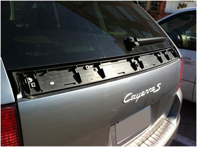

  5. Hey folks... I don't know if someone decided they needed this trim piece more than I did or if it came off in the wind. Anyone have a line on a salvage or used parts place for these type of things? I guess I could find a new one but used would be better..I can probably have it painted to match if I can find one (used and cheap would be best :D) thanks for any help or direction BTW I'm about an hour from DFW
