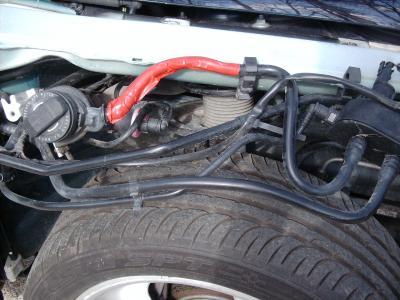

  3. Yes, the connector on the top/rear side of the charcoal canister. I do not see any place for it to connect altought behind the fuel fill door there is a rubber plug. Does it connect there?

  5. I need help determining where this hose connects. I purchased the car without the right front fender so I do not know where it goes. I think it goes to the fuel filler but not sure. I have put red tape on the hose to highlight it. Thanks for the help. The car is a 2000 base model
