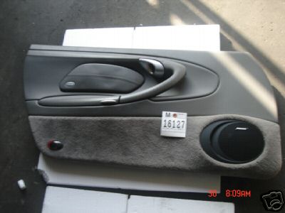

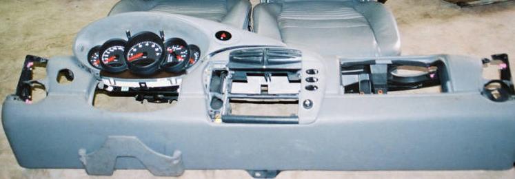

  1. This is the best picture I can find. I don't think it'll be much help though unless the identifying marks for a leather dash are pretty obvious.
  2. I have pictures of this guys seats and dashboard. Did the "leather upgrade" come as a set with other parts that may have identifying traits that I could see with those pictures? For example (leather door panels would mean that you had a leather dash too, and a leather dash is readily identifyable by looking for stitching on the instrument mound)
  3. Did 1999-2000 996's come with the option for vinyl door panels instead of leather? From what I understand, the vinyl ones look different than the leather. I'm just not sure if the vinyl only came in boxsters. (I'm buying a used set from someone who can't remember what they look like, but knows they came out of a 2000 996 cab. and that they are in great shape)
