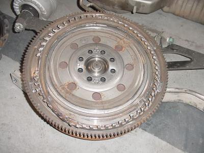

  2. The welds holding the timing ring gave out, the ring spun freely, knocking the sensor out. The rest of the wheel was fine. Very strange incident.
  3. Here is a pic of the timing ring, laying on top of the flywheel. Normally it is welded to the flywheel. Overall, I'm pretty happy about the outcome - especially Porsche's committment to backing their cars and maintaining the perception of quality.

  7. All right, you guys are gonna like this one... Just got off the phone with the service manager, and he said that PCNA has never seen anything like this one. The flywheel had somehow separated, parts fell off, and pushed the pulse sender out, causing the motor to stop. The "flying" flywheel parts scraped up the back of the motor a little, but didn't do much harm. Here's the good news... Porsche is paying for it ALL!!! I'm just going to pay for a new clutch disc while the thing's apart. I guess all the stories about "goodwill" are true for PCNA coming through when times are tough (and warranties have expired). I'll post pics of the broken flywheel for your amusement when I pick up the car later this week. Oh happy day!! :jump:
