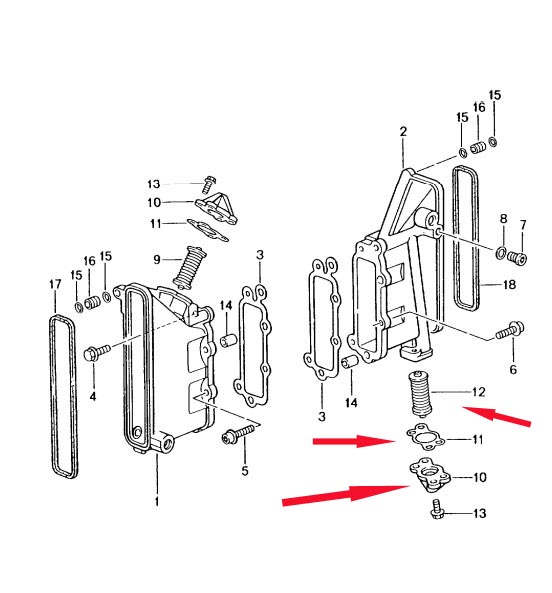

  4. Hay Guy's In this picture, the gasket (11) on my vehicle is weeping slightly, if I remove 10 to replace 11 will 12 fall out, and if so can I just push it back and replace 10 with the new gasket ??
