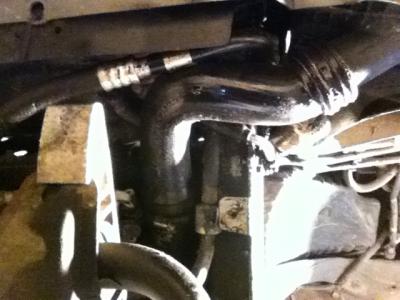

  14. Hi everyone, I have a slow oil leak happening at the far front drivers side of my 2004 Cayenne Turbo. I have it down to a fairly small area, but am not sure about the likely source as the whole area is a bit fouled up. Would you let me know what you think would be a likely source? I lose about 1 litre over maybe 6-9 months. First image is from inside the left wheel well looking forward, second and third images are from underneath the same location from different angles. Thanks, Mark
