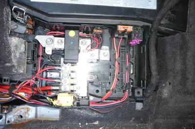

  12. Thanks, another good suggestion, I always thought that it was very costly, but I see now that you can get started for under $300. I told my wife what I want for my next birthday. As for the compressor, it is solved. Here is what I did: I exposed the relay in question and saw that it did trip when the car was started. Then I tested the circuit itself, and it had no power. That is when I remembered that there are a few additional fuses under the seat beside the battery. And that is it - the 40 amp fuse under the seat was blown. Replaced it and the compressor charges the system immediately and I am back to normal. So Loren, I suppose I should have been more thorough when checking fuses at the beginning. Anyhow, I am very pleased to have it solved, and as always, greatly appreciate the excellent suggestions and support of the community. Thanks, Mark

  15. Thanks for that excellent tip - I had no idea VW offered a repair kit. That could definitely come in handy. So, originally, I had a problem with the system charging, and traced it to an air line t-junction that had came loose under the rear seats. Once that was fixed, and over time, I thought that the compressor was beginning to sound more loud and laboured. A shop where I do some service mentioned that he had seen an older compressor that had accumulated a surprising amount dirt and water, so I took it out and disassembled it inspect it and clean the components - it was clearly dirty and had a fair amount of residue buildup. I replaced all the seals and lubricated it, and it worked beautifully - nice and quiet. However, upon reinstalling it in the car, it will not engage. My first check was the fuses, and I ended up checking them all as I know some systems can influence others (including under the hood). All are fine. As a double check I bench tested it again, and it works perfectly. So, that is what led me to believe that perhaps a fault code was registered since I started the car while the compressor was not present that had disabled the system. Let me know what you think, or if you have any more questions. Mark

  18. Solved! I started with the fuse box on the right dash, as I mentioned, the bottom two rows of fuses were getting no power. I disassembled the dash and fuse box and identified the power lined feeding these rows, there were three power lines. Following them back into the thick harness that runs from the fuse box then under the carpet passenger side, I found that all three are actually spliced together to form a single power line within the wrapped harness. Following this single power line, it ran back up and into the upper dash, along to the driver side of the car, down and under the carpet to a relay (the only one) mounted right beside the battery. At that point I tested the power and ground going into the relay, and also disassembled the relay itself and tested it. Power and ground were fine, but the relay was not tripping and providing power to the systems upon ignition. So next step was to test the power used to engage the solenoid and complete the connection. Power was fine, ground was not. I followed this small ground back up the harness and at a position roughly where your left foot rests, there was a series of spliced connections for a number of wires (again, within the wrapped harness). That was exactly where I located that this wire was spliced, and had corroded and came apart. I cleaned the wired, soldered and wrapped, and all systems are perfect. In the same location, there were a number of spliced connections, I inspected all of them and found another getting close to failure, so it was repaired in the same way. Then I resealed everything, and have no problems. To hopefully assist anyone with a similar electrical issue, pictures are attached: battery shows where the relay is that powers the systems (top right, relay removed, purple), harness shows the stripped wiring under the carpet, broken shows the connection as I found it. Ultimately, I believe it was moisture and salt that corroded the connection, although it looked poorly done in the first place. Thanks to everyone for your help, and please e-mail me if you have any questions of comments. Mark
