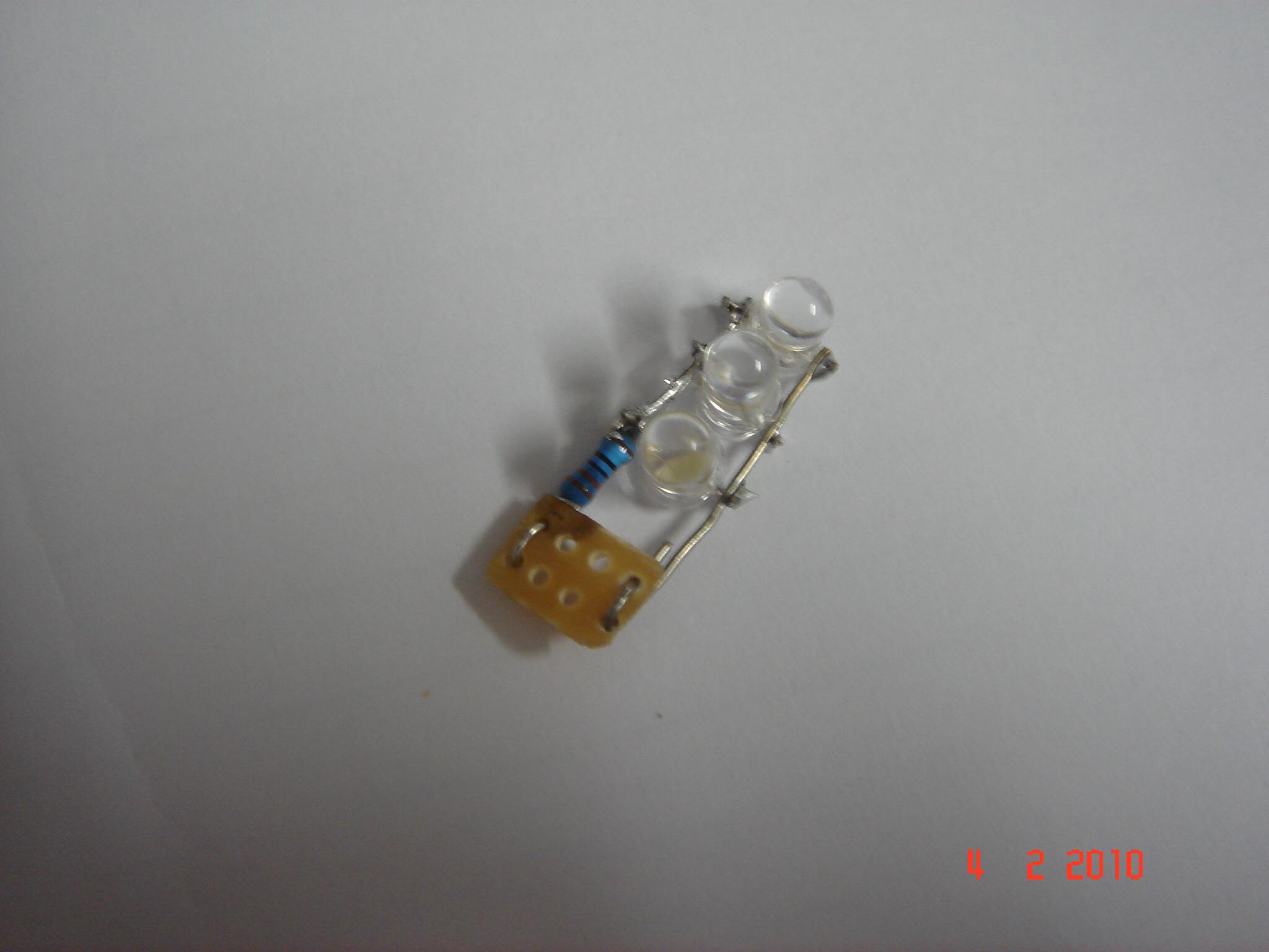

  5. Boxster 1997. Both of these lights were not working. Removed the light fitting (they just pop out with a small screwdriver). The connections to both of these light fittings were corroded. Strange, as the interior of the doors did not show any signs of moisture (like there was no residue). Cleaned up the fittings, and, presto, lights ON. After a few minutes, I found that the whole fitting was getting somewhat quite hot. No wonder, these are 5watt bulbs, and if you leave just one door open, both door lights are on, and for an extended period, I could see that the battery could suffer. Also, with this amount of heat, and trapped on the door panel, I can also understand why the connectors were corroded. So, I built LED fittings for each door. I used 24000 mcd LEDs at 30mA. A few photos to show the part I had made, and then fitted to the door. No1, shows the construction. The original bulb thickness in the socket is about 2mm, so I used some perf board, which is also about 2mm. This just thick enough to allow the wiring (which is wrapped on the ends) to spread the prongs in the socket for a good, firm fit. No2, shows the assy fitted to the socket. No3, shows the outcome.

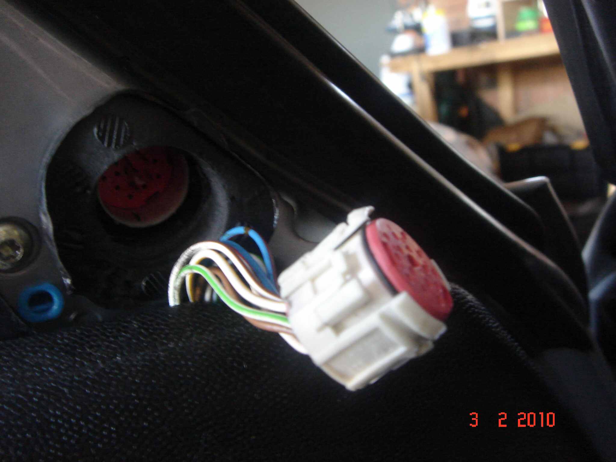

  6. I had recently purchased the 1997 986, and it came with a few electric issues. The wing mirrors did not work. After reading many of the posts in this forum, I decided that the problem may just be in the connections. Albeit, the car is 13 years old. I have found that the connectors in each door had worked loose. I have described the process here. Photo No1, shows how to just pinch off the cover on the door (also, good idea to put down the window) Photo No2, shows the cover off, and the mounting points. The blue inserts are the mounts, and maybe damaged. Also the pic shows the plug. Photo No3, shows a closeup pf the plug. Photo No4, shows the plug detached. Notice the snap in clips on this plug. They will snap into the receptacle on the door. The receptacle has the female part, and these were broken. So I used double sided tape, wrapped around the where the clips are on the plug, and pushed the plug back into the receptacle. Photo No5, just shows the receptacle.
