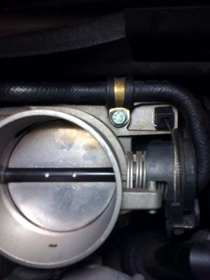

  2. Problem solved. As I was removing the throttle body I discovered the throttle cable had pulled out of it's slot behind the black plastic plug (not visible which is how I missed it). Once I repositioned it there's enough cable for the car to idle properly. Boy do I feel stupid! Thanks again for your assistance!
  3. Thanks Loren for the advice. I checked the throttle butterfly, it's not binding, the movement seems fine. Yes, it is a C2 but I'm not sure how to check the idle control valve to see if it is stuck open. I've attached a photo that might help in figuring this out. Notice the gap between the idle set screw and the throttle? I can force it down with a screwdriver, then she purrs like a kitten at 700 rpm, but as soon as I let go it jumps back to 3000 rpm! Very discouraging considering I spent the last 8 weekends replacing the clutch, main seal, and every hose, belt and filter on the car. All thoughts are much appreciated!
