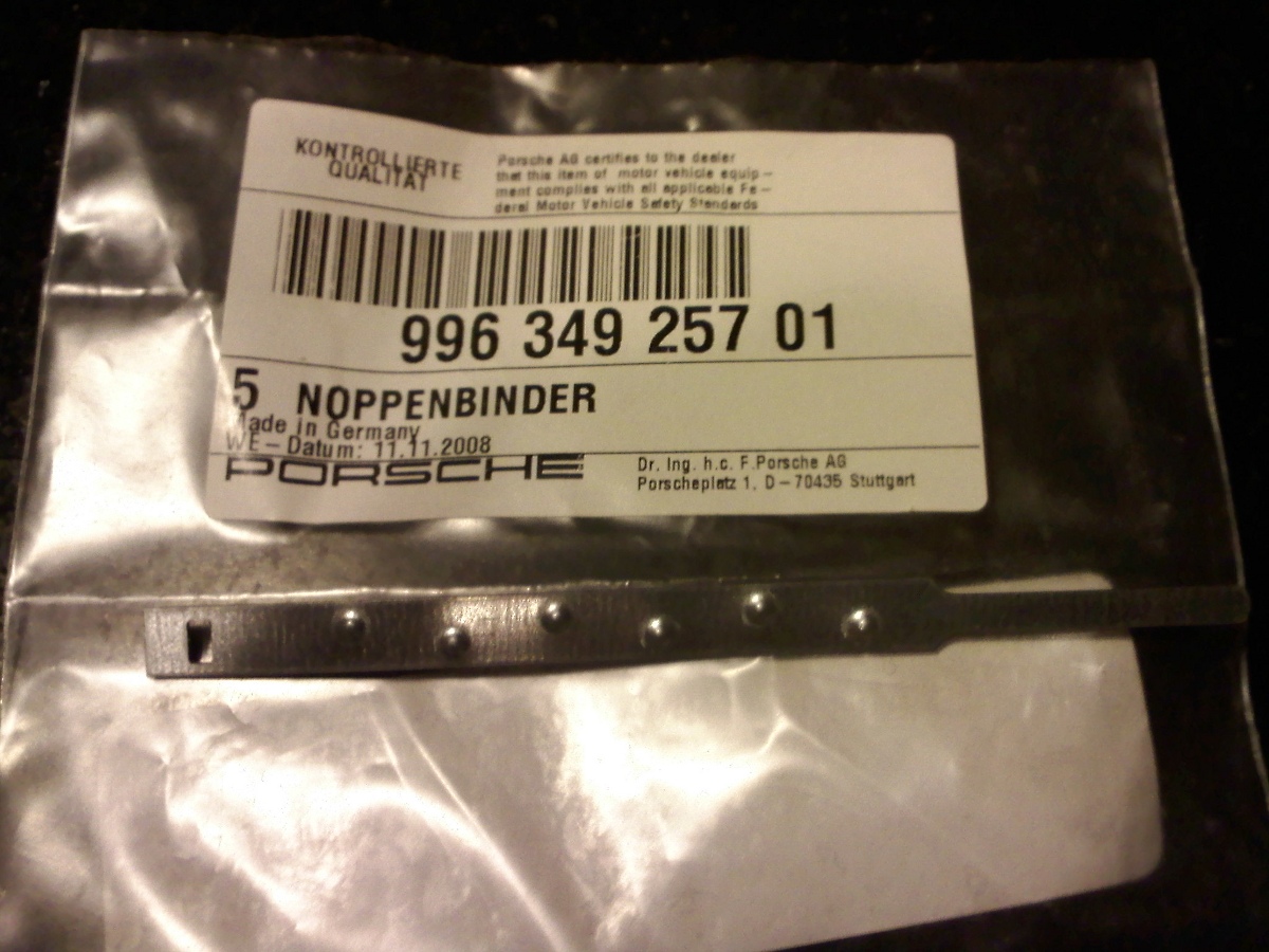

  2. I've got my new boots and clamps and I'm ready to tackle the job on my 996 C4. Just one question: This is one of the clamps that arrived and I'm a little confused about how you tighten it. I've got CV boot pliers for eared and earless clampes which the other ones are. This one just looks like a metal zip tie. Do I just pull it through and bend it over? Thanks, S.
